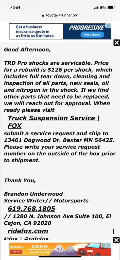

Fox recommends sending them in every 50k to be done and such. At least I believe 8 read that somewhere.
Yeah 50 is what I have heard.
126 a shock is the fee

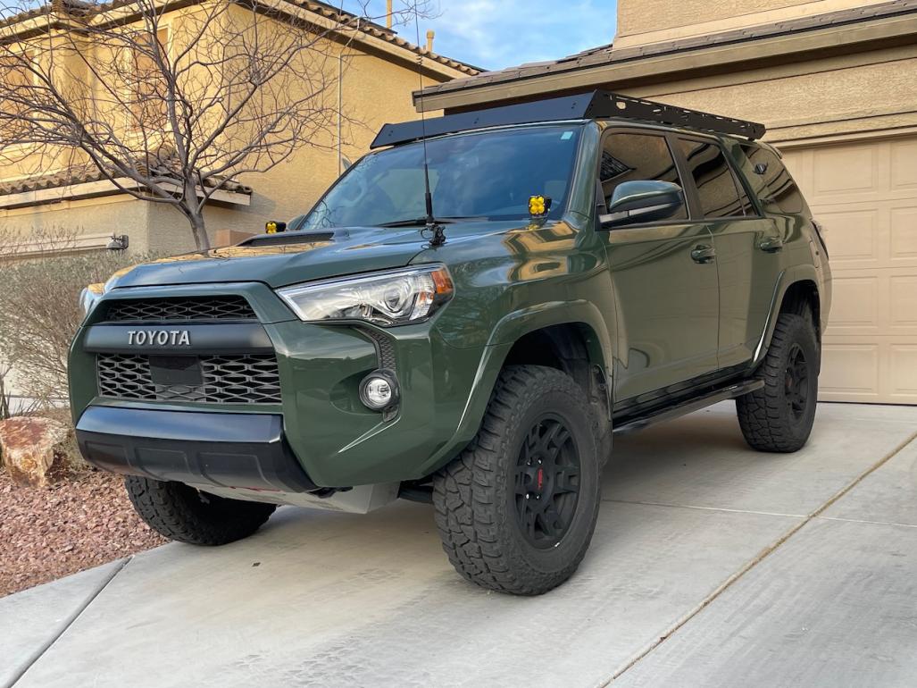

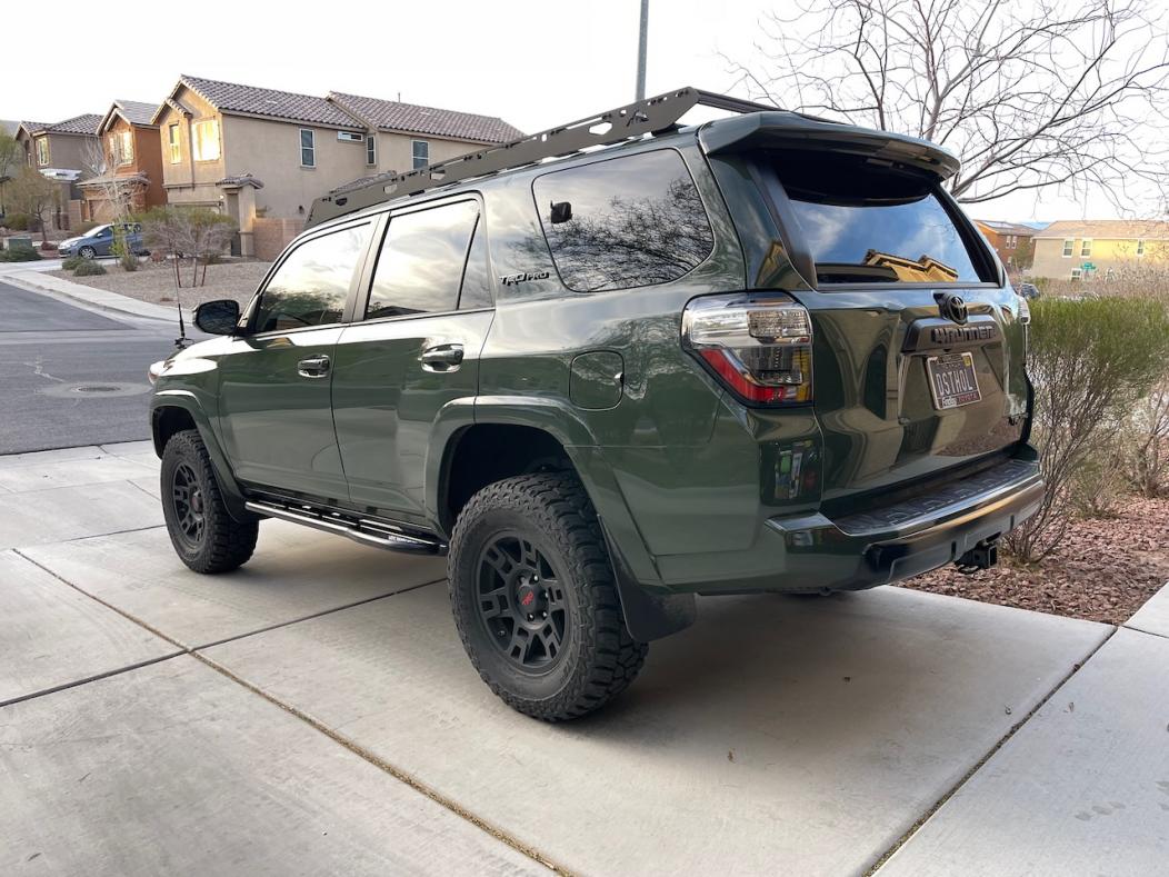

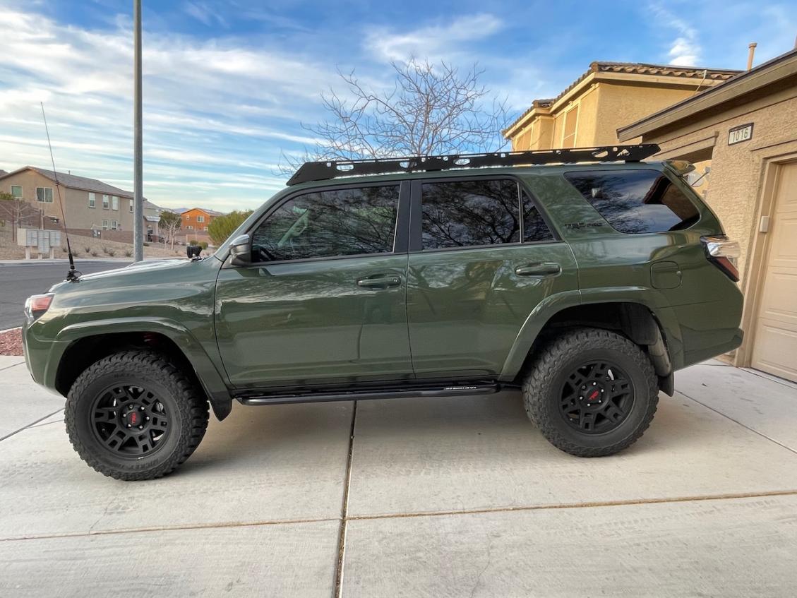

Got these installed yesterday...I swear the truck should have come from the factory like this. Great job to Eibach for making these available!

Looks great. What tires and size are you running?
Thanks. I’m biased but I really think it’s sitting really nicely.
The rubber is Mickey Thompson Baja ATZ P3. E rated in stock 265/70-17 size. They work amazingly well in the desert environment.
Took it out yesterday for a shake down run, couple hundred miles of mixed pavement and dirt deep into the Mojave Preserve. The springs feel great. No change in ability to tackle the washboard and whoops at speed and the added clearance was immediately noticeable too. It’s a great solution for the Fox Pro shocks and competes the set up.
