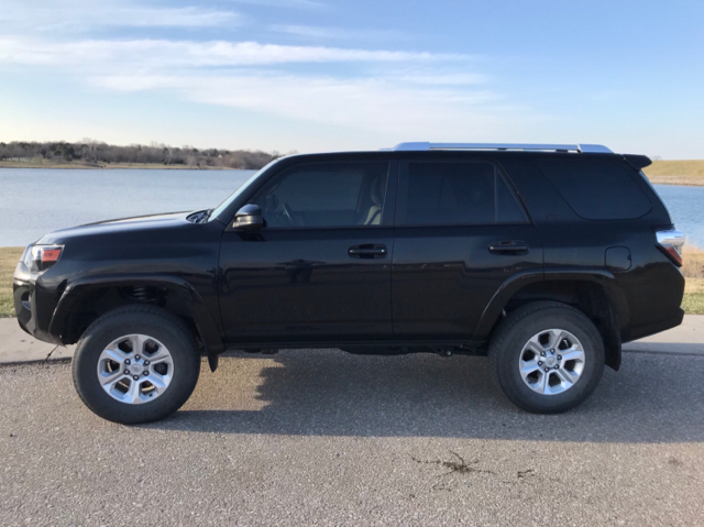

Day of install:
After settling (posing next to [MENTION=139460]Terra Firma[/MENTION] with his Icon Stage II):
So far, I would highly suggest if you’re looking for a good ride, slight lift & level. You only need what comes in the kit, no diff drop or anything else.

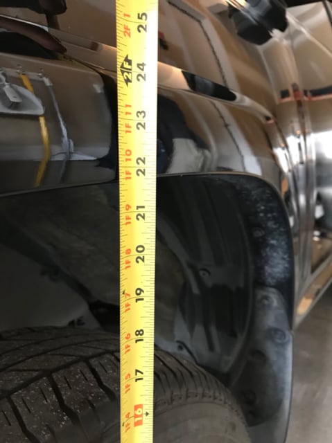

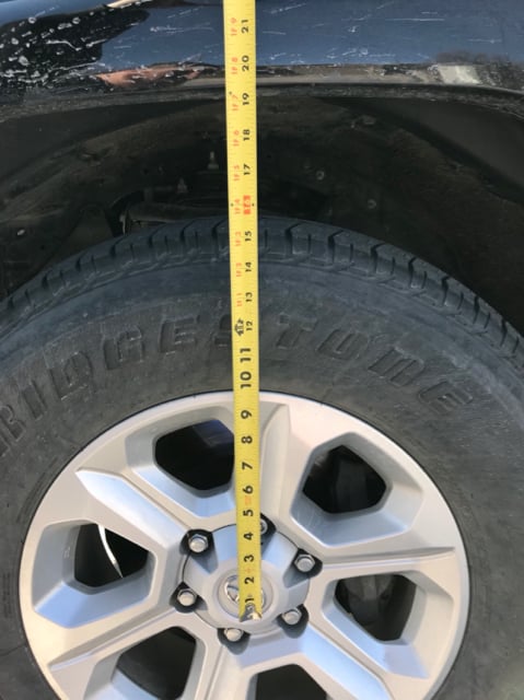

I would guess it got very close to the spec that Eibach gives. Here’s a couple “unofficial” measurements up front. It looks to be 2.25” hub to fender increase, but the way I measured could easily have .5” wiggle room.
Before:
After:
