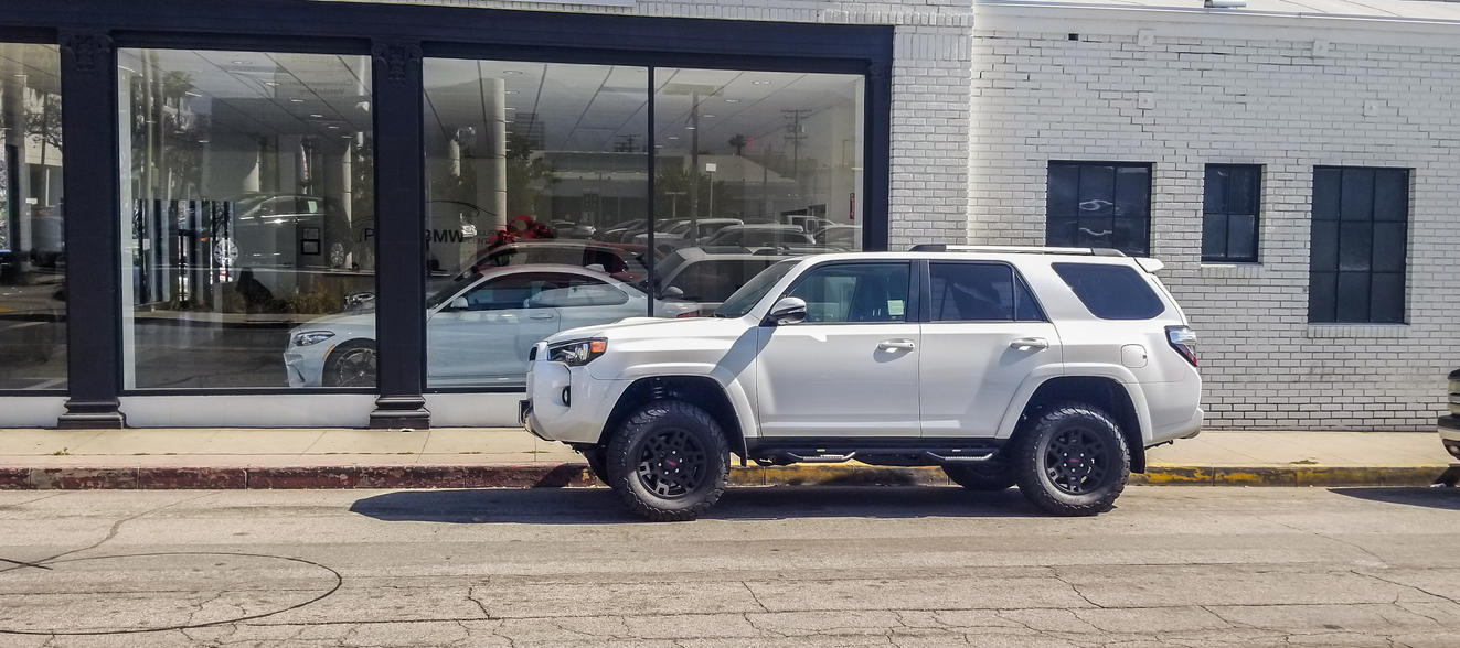

I would guess it got very close to the spec that Eibach gives. Here’s a couple “unofficial” measurements up front. It looks to be 2.25” hub to fender increase, but the way I measured could easily have .5” wiggle room
How’s the frame rake? With the advertised 2.75 front and 1 In back seems like you would get some reverse rake?
I thought that too, as did a Wheelers sales rep. I contacted the manufacturer to double check, they claimed "it would be level". Like i said previously, i haven't made the settled measurements, but to the eye, everything appears level.
Can u measure front and back when u get a chance?
Very interested in settled measurements (and more pics) when time allows! I have a '15 SR5P and am getting ready to jump on either the Bilstein 5100s all the way around or this Eibach Pro Lift. Like others, vendor measurements concern me re: reverse rake. I tow a 3000 lb boat all summer which is currently no problem. As soon as the truck/boat is loaded with people and gear, sag occurs. I want to correct that - not add to it with the Eibach set up. Thanks for these posts, guys. I'm addicted and learning a ton!

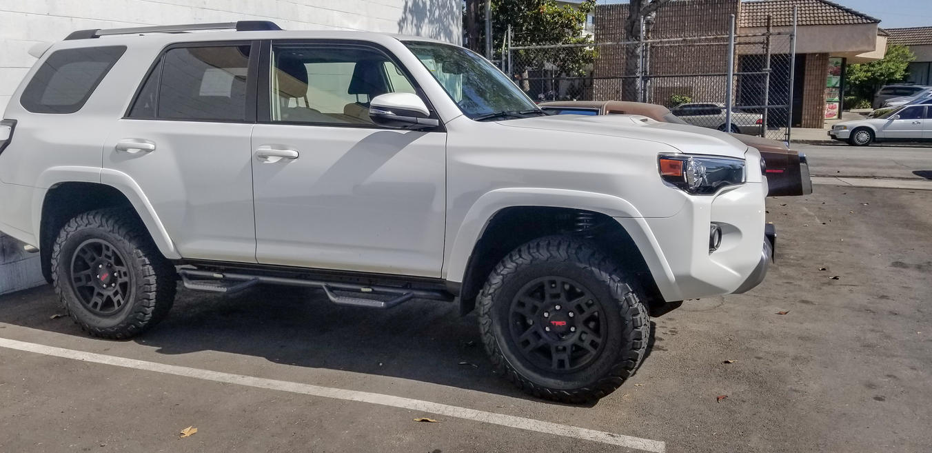

Eibach pro truck stage 1 4runner 5th gen
+2.75" front and +1" rear seems a bit strange. It's going to be butt sagging pretty good like that.
My front is 3/4 inch lower than the rear but only drove about 40 miles so far

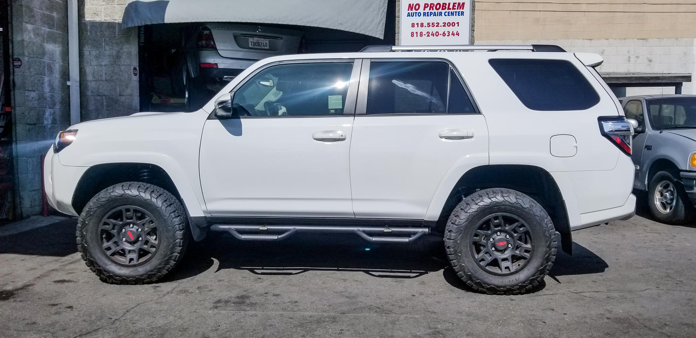

Day of install:
After settling (posing next to [MENTION=139460]Terra Firma[/MENTION] with his Icon Stage II):
So far, I would highly suggest if you’re looking for a good ride, slight lift & level. You only need what comes in the kit, no diff drop or anything else.

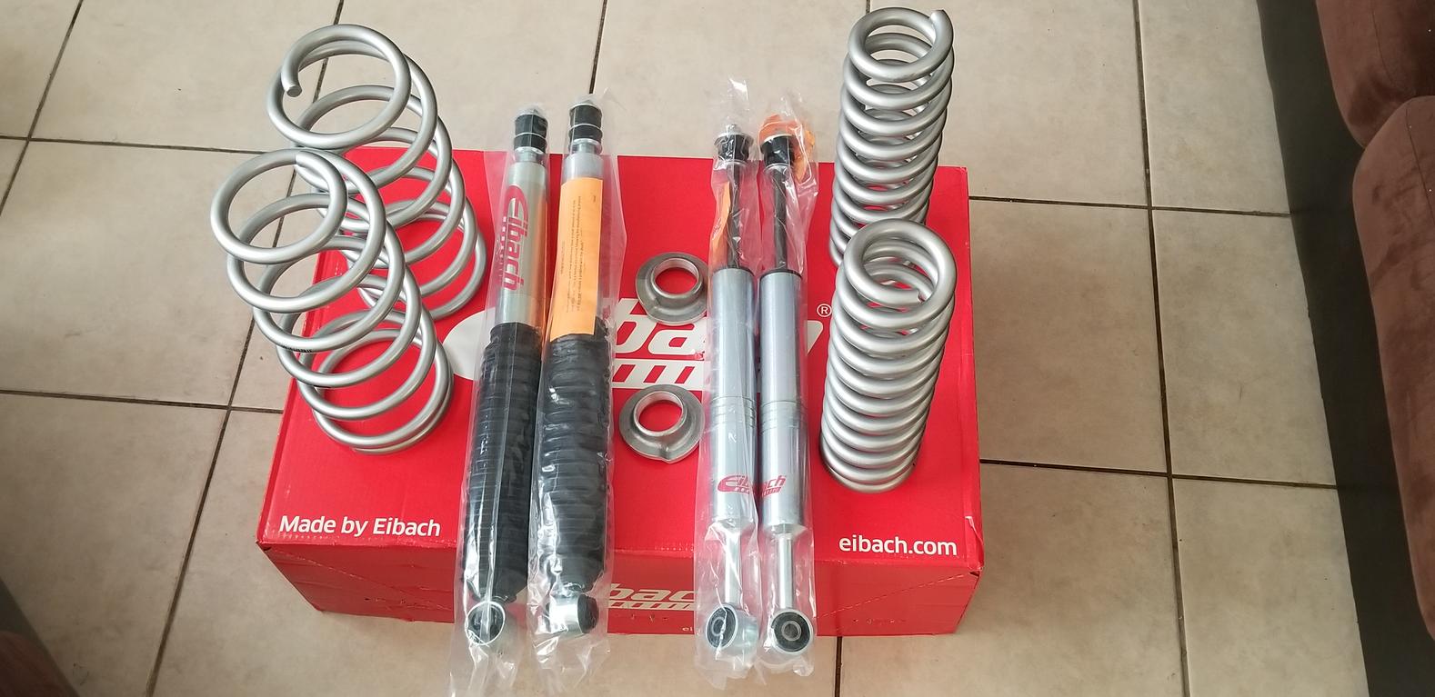

Spring rate?
Damn, this eibach kit is growing on me more and more, especially at that price tag. Was looking into Bilstein 6112/5160 with wheelers, but I might change my mind.
Does anyone know what the spring rate is for the front springs? Couldn't find any info on it. I'm guessing 600#?

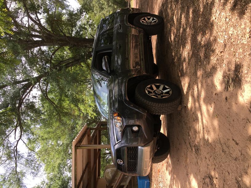

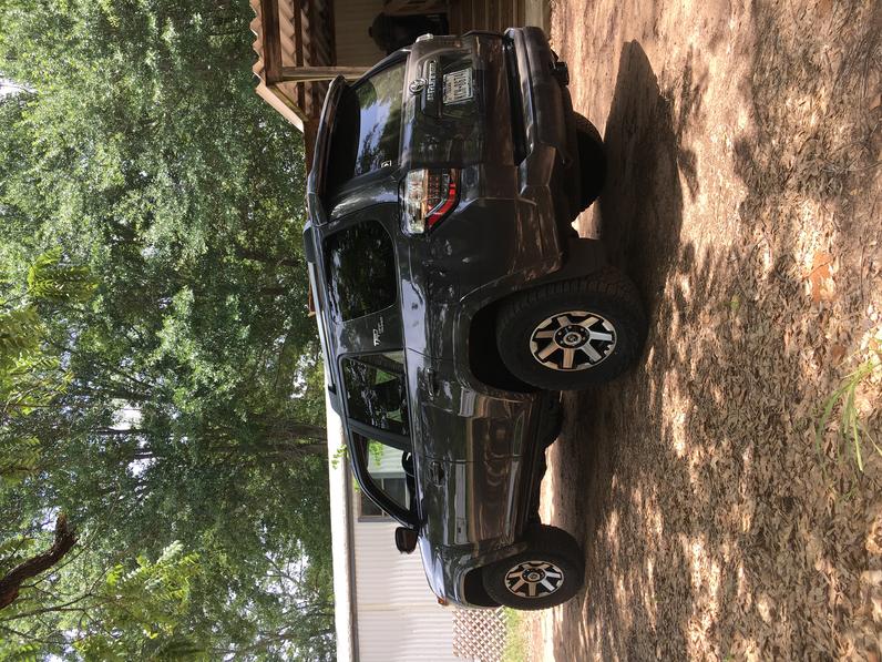

So I just got done with my install and so far I am very happy. I like the hieght and the ride is great. Really good parts from Eibach. Went with Falken AT3 in 285s and got zero rub. First time posting pics so I hope this works.
Awesome! Is there a little bit of a reverse rake or is it pretty level?
