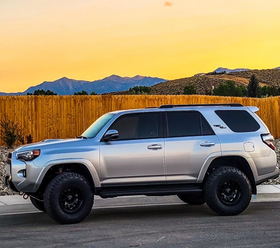

Have been running the eibach pro truck lift kit for almost 3 years now I think. Have the fronts set to 2.75" and the load leveling kit in the rear to give about 2" of lift. Also running 17x8.5 -10 Ray 10s, JBA UCAs, and 285/70 BFGs.
Rides and handles great, eliminated the nose dive while braking. The truck became a bit more sluggish off the line but it's a 4runner, still drives great.
Had to push forward the front fender liner, do some minor trimming to the front bumper, the black valence caps, body mounts, and remove the front mud flaps. After all that, no rubbing.
I'm getting ready to replace the BFGs and thinking about going up to the Toyo AT3 in 285/75 (34s). Anyone else running anything bigger than a 33 with this setup? Just additional trimming to the front bumper and hammer the pinch welds? Regear?
