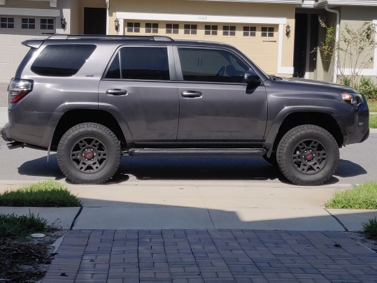

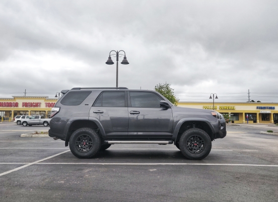

Install complete. Aligned up within specs no problem. Took about an hour and a half to install the lift and about 20-30 minutes to align.
Stopped and got some BBQ after alignment, took a picture while there and the 4R looked a little high in the front... So I went to my garage, where the ground is perfectly level, and did some very "scientific measuring"... If it's not perfectly level, it's so close I can't notice it with my eyes. I'm happy. There's a little bit of driver's side lean... But I didn't notice it until I was really looking for it.
Tires ordered. Should be here next week and after installed I'll take some nicer pictures.

Looks good! what did your caster specs come out after the alignment?
I just got mine put on and I am unsure they did the alignment right.

The caster is at 2.3 and 2.5 after lift and alignment. everything is within specs according to the sheet.
Did they give you an alignment sheet that shows everything?
Wheels stayed the same size. 17" but the offset changed a little bit. Went from 15mm to 10mm. Not very significant.
Yeah after doing some reading about other people experience I think they got lazy with the alignment and didn't move the lower ball joint forward. Mine came out 1.5 and 1.7 it didn't change from before and after the alignment...
Casters were the only thing out of spec, but they tried to sell me on the cross caster alignment which was in spec.
