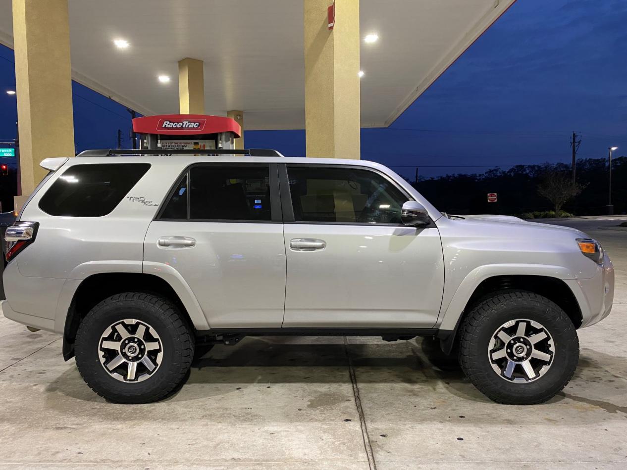

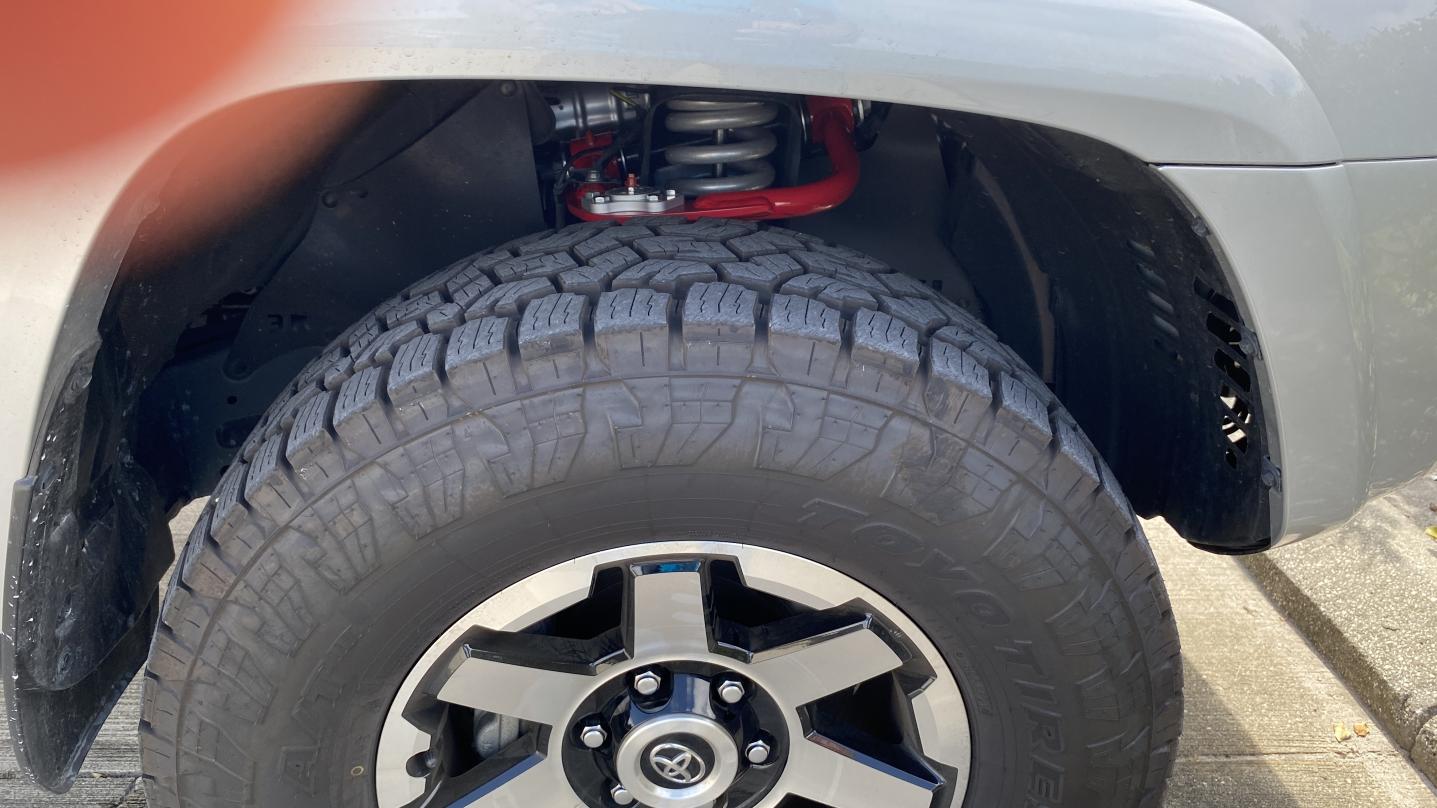

Finally! After reading thru what seems like hundreds of posts.
2.75" front / 1" rear.
Toyo AT3 P285/70/17
Kept the stock UCAs and mud flaps, only did the fender liner mod. no rubs but its a street machine. Ride is improved and feels smoother. I like it much better now.

Looks great!
I’m getting tires soon but plan to stick with 265’s for no rubs and better mileage. I have the Stage 1 kit as well, but I used the factory front springs.

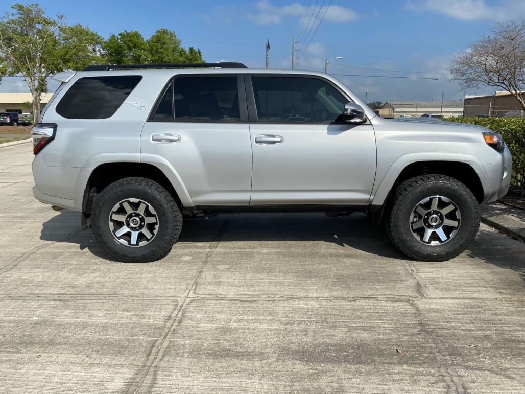

It's a great setup. This is mine, running Toyo AT3's in 285. I did end up doing a BMC due to some minor rubbing at full lock on the driver's side. I also went with the Ironman Pro Forge UCA's. I couldn't be happier with the ride on or off road
Sent from my SM-G965U using Tapatalk
JBA's on the way. Caster improvement needed for tracking on the highway. Its not bad at all just a little darty.

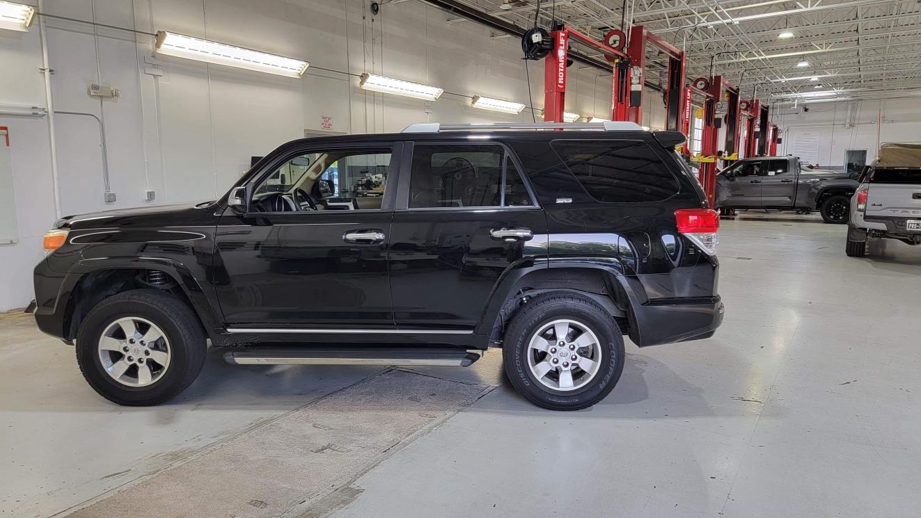

I just had mine installed last night on 2011 SR5. Eibach Stage 1 Lift. 2.75 / 1. Still have about .75" rake which is perfect. I was really worried about a reverse rake with this kit.
I want to run 285/70/17's, but don't want to do a BMC or any major trim work. What are the odds I'll get lucky and they will fit? Stock UCA's and the alignment got it back to spec (which I believe is 3.7* caster).
