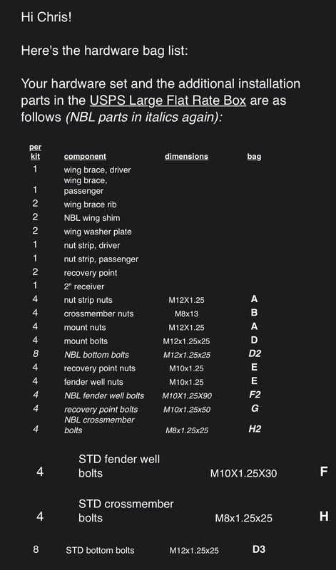

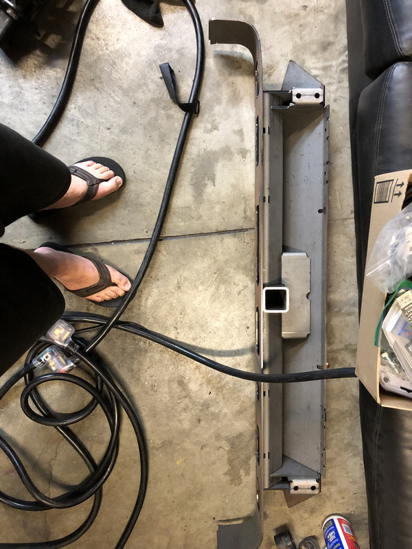

vs what I got? did you have to weld them together? I'm still thinking I got the wrong hardware packs and some parts for some other kit he makes? anybody?

The kit is somewhat confusing, you did get the correct brackets though. I have a bolt break down if you want me to post it as well. I got the non BL kit then decided I wanted a BL and sold the non BL brackets and bought the BL brackets lol.. I have it pretty much figured out, haven’t put it together yet though.. I’ll try to post some pics of where pieces go.

I got an email back from Kieth and yes I have the correct brackets for the non body lift version.
