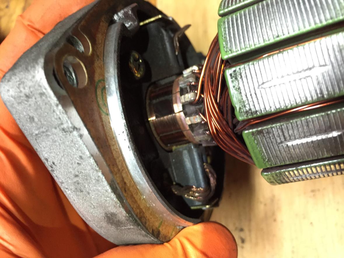

I pulled the DC motor out and took it apart. It looks to me as if the brushes are worn down to the end of their useful life. I cleaned the motor out, lubed it and was able to get it to work for another 5 minutes before it stopped again. Tap on the side of the motor and it'll work for a few more minutes before stopping again.

One of these contacts is not like the others.
