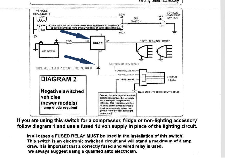

Ok, so I pulled the trigger on a 30" LED light bar. I have found a diagram on this site that I think will allow me to turn on the LED light bar when the high beams are turned on.... am I correct? see diagram
The diagram shows a relay. I understand what the relay will do. How do I go buy one, meaning that the diagram doesn't give any specifications on what kind of relay to buy. What do I ask for at AutoZone?
The diagram also shows a Diode. I understand what the diode will do. How do I go buy one? Is this something AutoZone would normally carry? Do I need more information that it is just a 1 amp diode?
If it helps any the light bar will be 300 watt with a 12.7 amp draw

Relays are relatively easy to find. Your local autoparts store will have some in the electrical aisle. As for your diode... you can find it at radioshack provided your local shop didn't close down like so many others did... otherwise you can find them online.

Also, if you use two relays, you can hook up the light bar so it turns on via a switch if the lights are off, but when you turn the lights on, it will only come on with the brights.
That's how I did it on my Land Cruiser. It's nice if I want to have only the light bar on without anything else.

From what I see the wiring plan shows all the random ground wires grounded together. I'm talking about the wire nut picture in the lower right. Overall this is NOT something I would do.
If you take the extra time and ground things individually, you won't have an issue. If you run pin 85 (the ground side of the trigger relay) to a ground, you don't need the diode. There is nothing wrong with a common ground. If its truly a common ground, you woudn't need the diode.
Personally I don't like extra components. Its just something else to fail later. A little extra wiring and breaking out the grounds may be worth the effort.

I don't understand your common ground comments.
The ground in the lower right corner of that diagram is only used for a lighted switch. (Note the illumination +12v going to the switch in addition to the ignition switched +12v) If the switch wasn't lighted in that example, that ground wouldn't exist.
Also, in that example above, you can't ground the relay. That diagram assumes that the high beam trigger is negative, so the opposite side of the relay has to be +12v.

Ok so I go to autozone... there are dozens of relays to choose from and I still don't have any idea which one to get based on the diagram I posted at the start of this thread. How do I know which relay to get?

A standard 4 or 5 pin 30a relay will work- any autoparts dude worth his paycheck can direct you to one of those- no need to over think it.
If you get the diode, make sure you install it the correct way. Look at diagram above, the doide will have a silver line around one end, that will correspond with the line above the arrow in the diagram (silver line closest to relay). If you install it backwards the light won't work.

The diagram is setup so that the light bar can only turn on when the high beams are on. The switch is there so that you have the ability to control the light bar when the high beams are on. If the high beams aren't on, the light bar will never come on.
The switch looks like its a lighted switch. I am not sure how it operates but, if you use a 12v LED instead of a regular diode, the led will light up when the light bar turns on. Something to think about.
As for the relay, go into the part of the store where they sell the cheap universal driving lights. You're gonna see 2 or 3 things. The first will be a universal fog/driving light harness. That will work, it has everything you need, the downside to this is these harnesses I feel don't have thick enough wire and the wire is either too long or too short. The second thing you will see is just a plain relay, it is probably the replacement relay for the harness I just mentioned. This relay will work, its probably a 30a 12v SPST relay which is the most basic type you need. If you don't already, you're gonna need some female quick disconnects to connect your wires to it. The third thing you might see, and you'll see this if you're luck, it will be a relay with a small pigtail harness so that you can connect your wires to it, and if the relay fails, you can just swap it out without figuring out the wiring, just unplug the relay and put a new one in.
