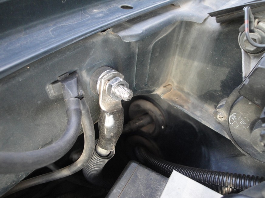

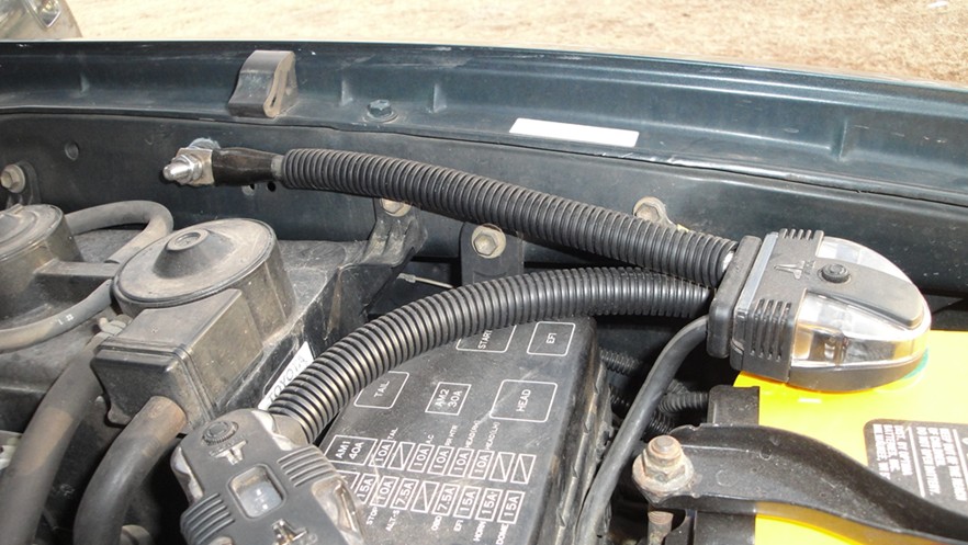

If you do the Big 3, here's what my Big 2 look like:
Battery to Ground: totally replaced the existing wire and ground point

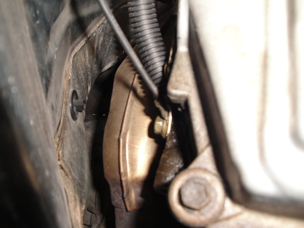

Engine Block to Ground: added 2 gauge to the existing ground attach point on the rear of the block and ran it to the right fender wall. You can also see my amp power cable running through the lower grommet on the passenger's side.
