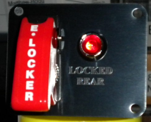

Elocker conversion on a '97 - pics included
I wouldn't even waste my time with the ECU. Then you can only use the locker in 4lo. Just wire it up to the switch & you can use it in any mode.
Great find & price!
this.

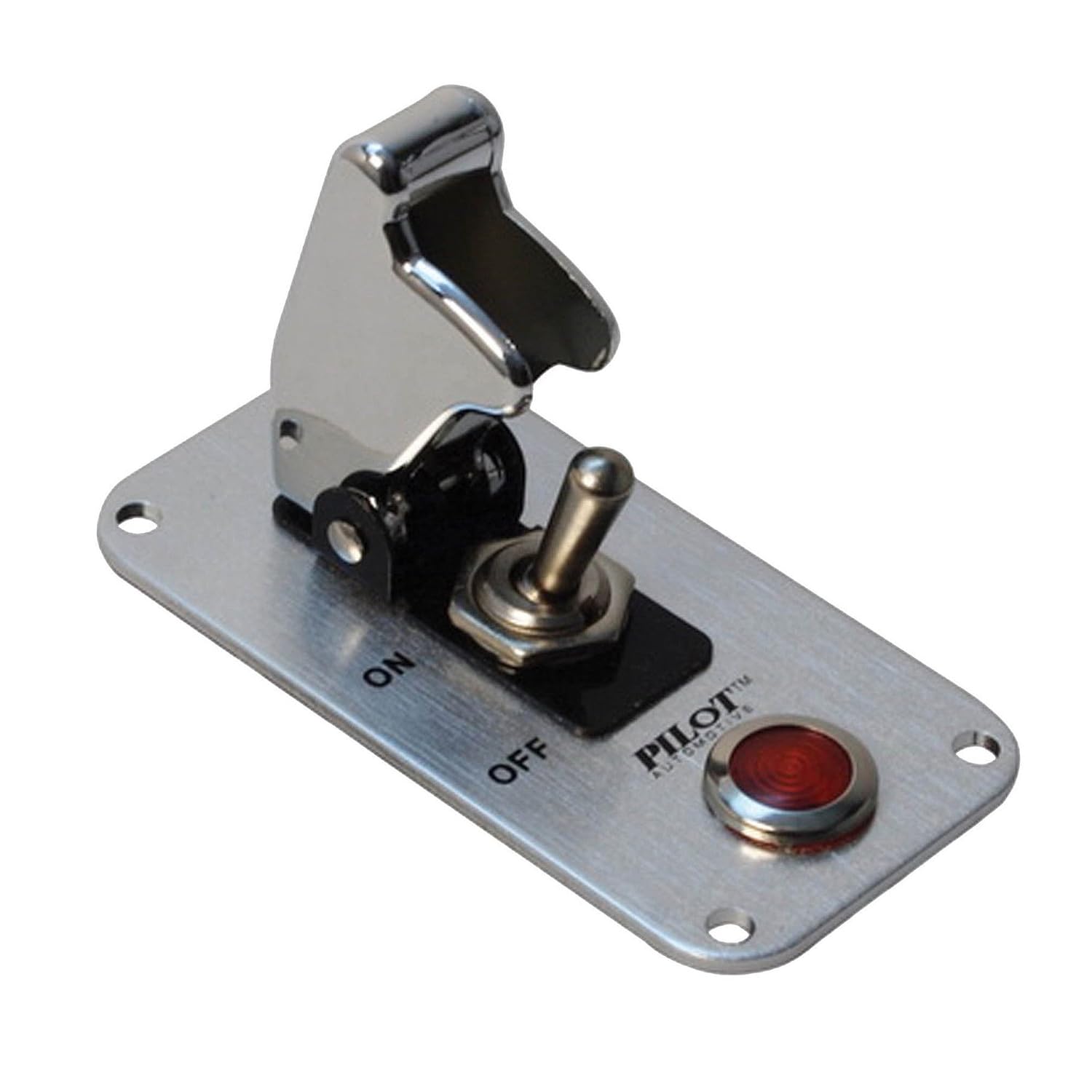

maybe a switch with a cover so it is not accidentally engaged. (without the ECU, it will/can engage in any driving condition)
something like this
