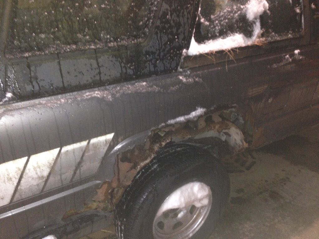

Don't feel bad I would kill for something that clean my 84 looked like this and that's good for my area! IMG_2563.JPG
haha! I guess that kind of puts things in perspective... I guess a californian can't really complain about rust..

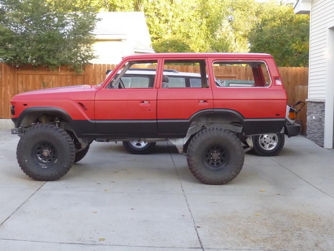

I think you should do bright red sprayed on monstaliner!
Like a cherry red? Would look nice. I'm leaning towards the rusty color similar to what I have or maybe a desert tan. Or neon green :p
