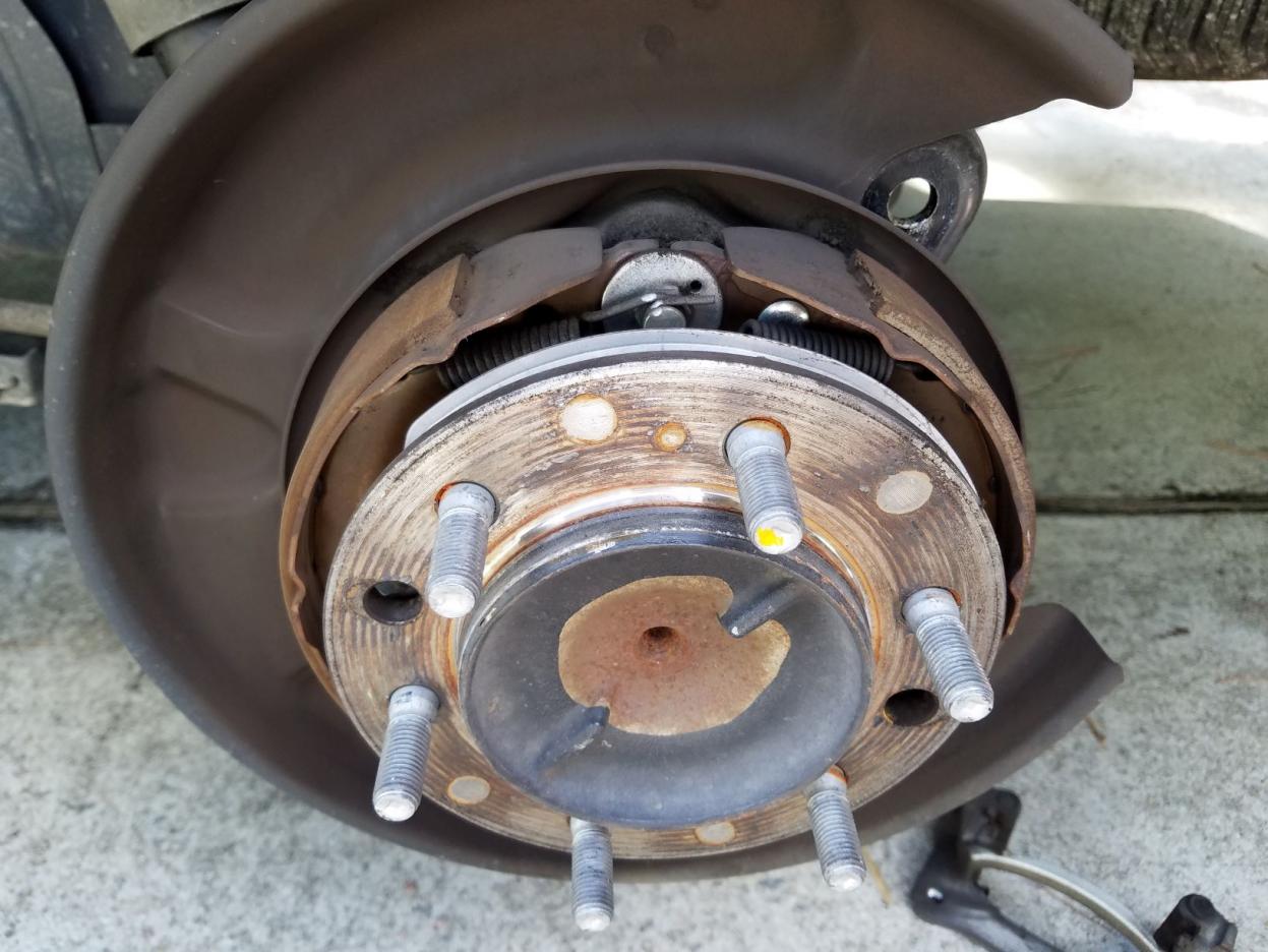

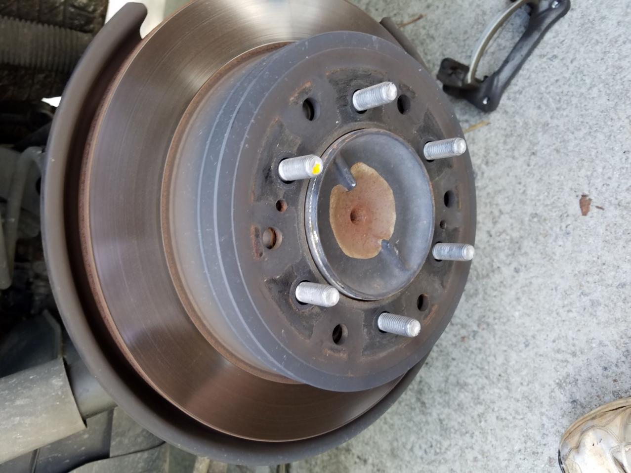

Here is the hub/ebrake behind it. You should have holes like the two on mine. The holes in your rotor should line up. My rotor has a hole between each stud. If not, I'm confused.
