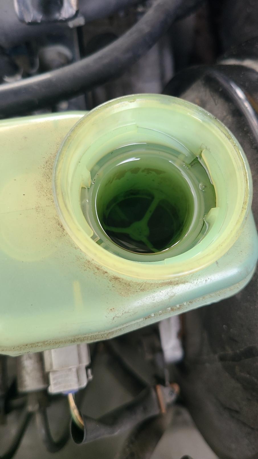

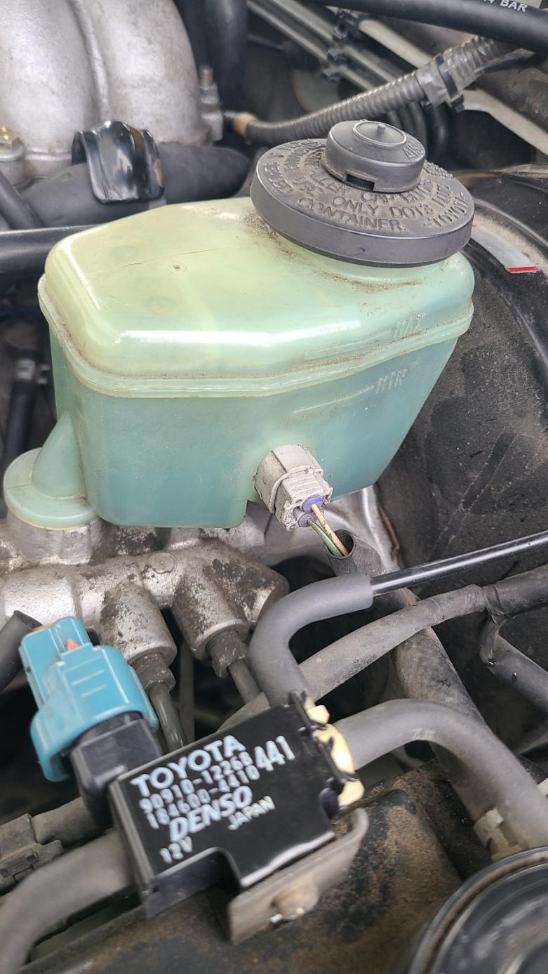

Pic related is my master cylinder. Green as a Jolly Rancher, except this time it's still pretty clear; typically when I bleed my brakes it comes out looking like swamp water. This fluid has only been ran since mid September, and my ABS has been off the entire time (haven't gotten around to replacing the front left sensor)

Just how green is the fluid? I feel like the container might make it look a little darker than it is.

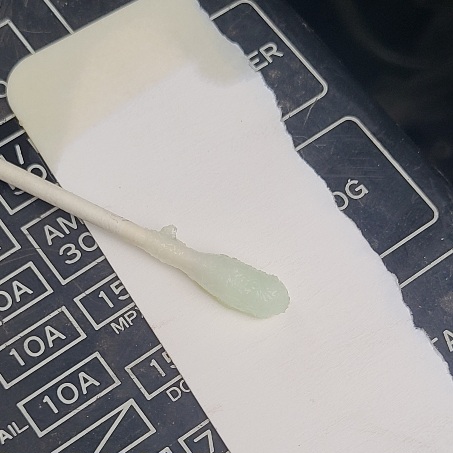

Can you post a picture of the fluid on a white paper towel or piece of paper? Some of the reservoirs I've seen on Toyota's age green for some reason.
Here's a cotton swap dipped inside, it showed up on camera the best (but still not great, it's a little more green in person). I used to have a clear bottle filled with a bunch of it, but apparently it got dumped into the waste oil at some point, that would've been perfect
My reservoir definitely has a tinge to it, I can see the plastic itself is green where the small air pocket is. Whether that's from age or getting dyed by the fluid I'm not sure. Unless the fluid is eating it? Doesn't seem likely but it is almost 30 years old now. The reservoir DOES make it look much more colored than it is though

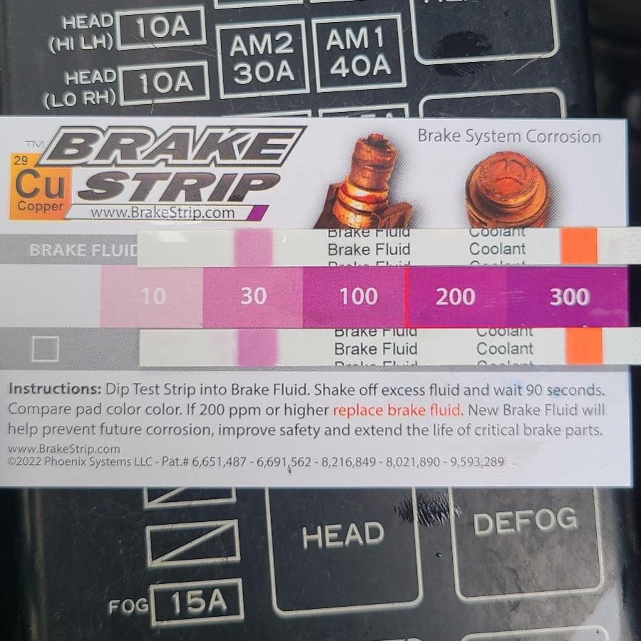

Welp, got the test strips today and according to them some copper is present but it's still way good. The camera picks up the color difference a little better but to the eye it was the exact same color as the 30ppm marking. Considering this and also how it's still much clearer than my previous bleeds, and the fluid is less than a year old, I wonder if my suspicions are right about old fluid still being trapped in the loop somewhere and is causing the rest to dirty up? I would still suspect the ABS box but I'm not sure if fluid passes through it continuously or if it bypasses it somehow and only mixes once the pump is tripped by the wheel speed sensors
