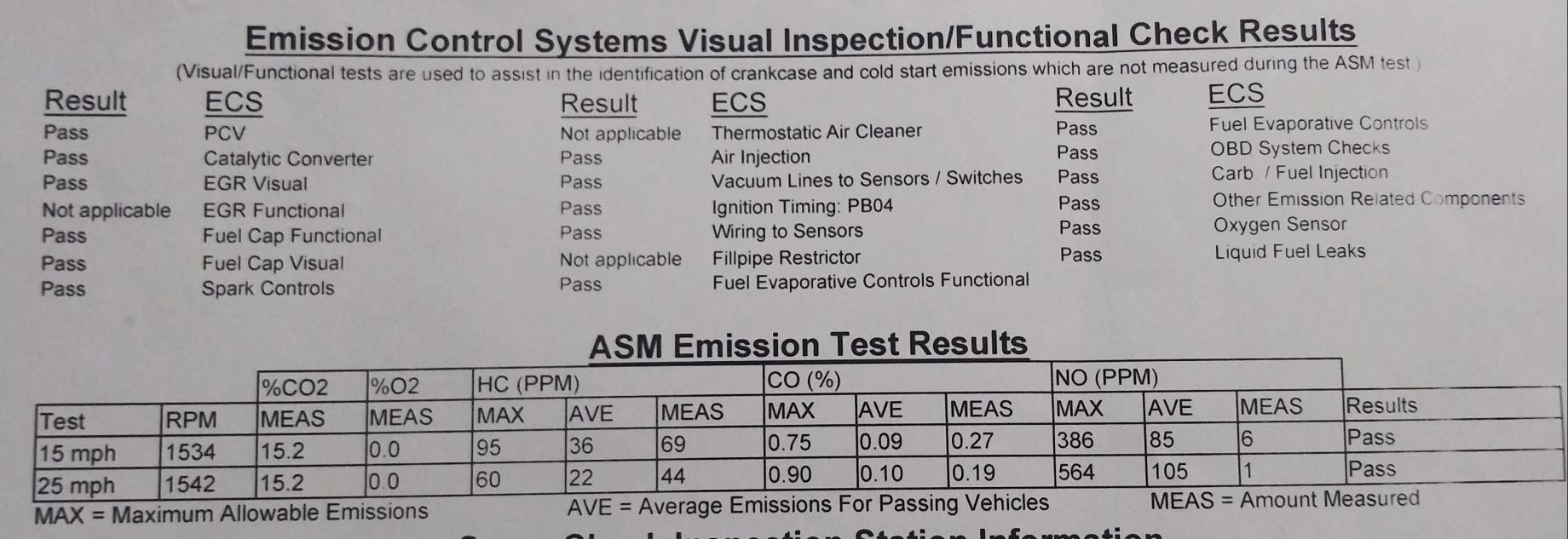

Hi guys,
I am new here. I am curious what you guys think after seeing my 1993 Toyota Pickup 22re 2.4L Automatic California Emissions test results. Also what does ignition timing: PB04 means?
Is this good running truck? Mileage is 186,500.
Thanks
This is an old thread, but your question is up-to-date, so I'll reply.
Your NOx emissions look great. That means your EGR system is working properly.
CO and HC are passing, but creeping up. Your O2 sensor may be getting tired. Mine did the same thing last year, and replacing the O2 sensor (the upstream one, before the cat) dropped the HC and CO emissions by 2x or so.
O2 sensors are cheap and pretty easy to replace, unless rusted in badly. Get a Denso from Rock Auto. Don't buy a parts store substitute.
Not sure what PB04 means - I'm not in California. That's not a code from the truck itself - the truck only produces two digit numerical codes. Probably a code that says the tech checked it with a certain methodology. You'd have to ask the tech.
Looks healthy for 186,000 miles.
