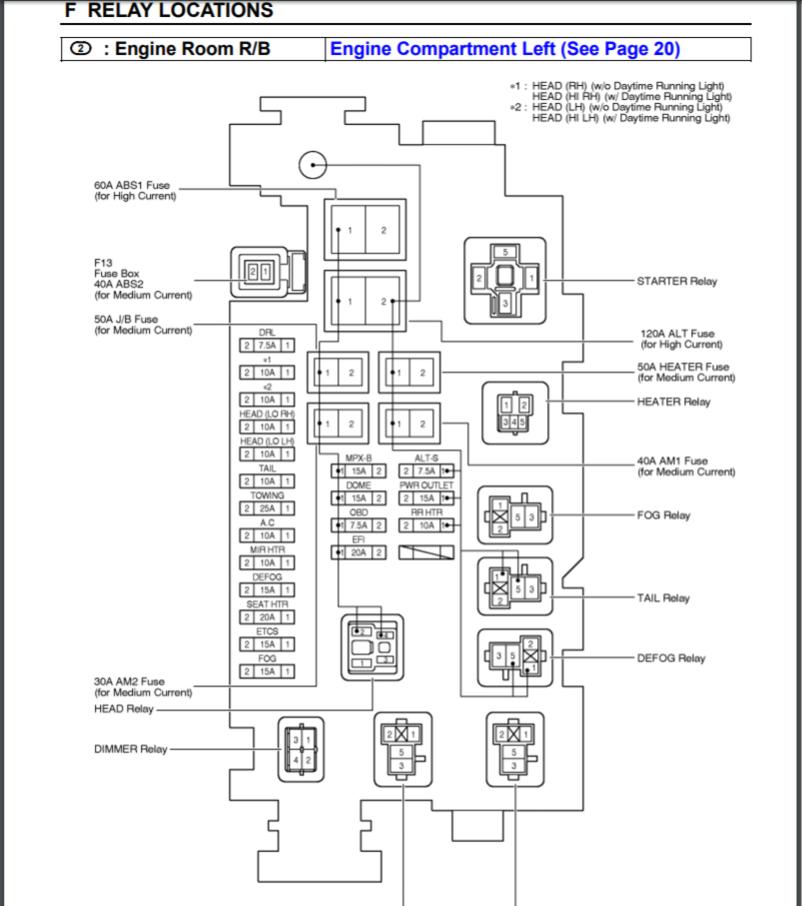

See the pic attached from my '99 fusebox, right hand side close up: the stud on the top right comes from the alt while the bolt head visible towards the bottom comes from the battery.
Hell yes, perfect pics man, thanks!
So those two wires going to the engine fuse box are both hot, so hold red lead to one at a time and ground the black wire from the tester right? Test with engine running and also off? Just making sure I don't miss anything.
Both of those should be full time hot, engine off or running. Voltage will vary depending on running or off.
Ok, so I'm just making sure they actually have power right?

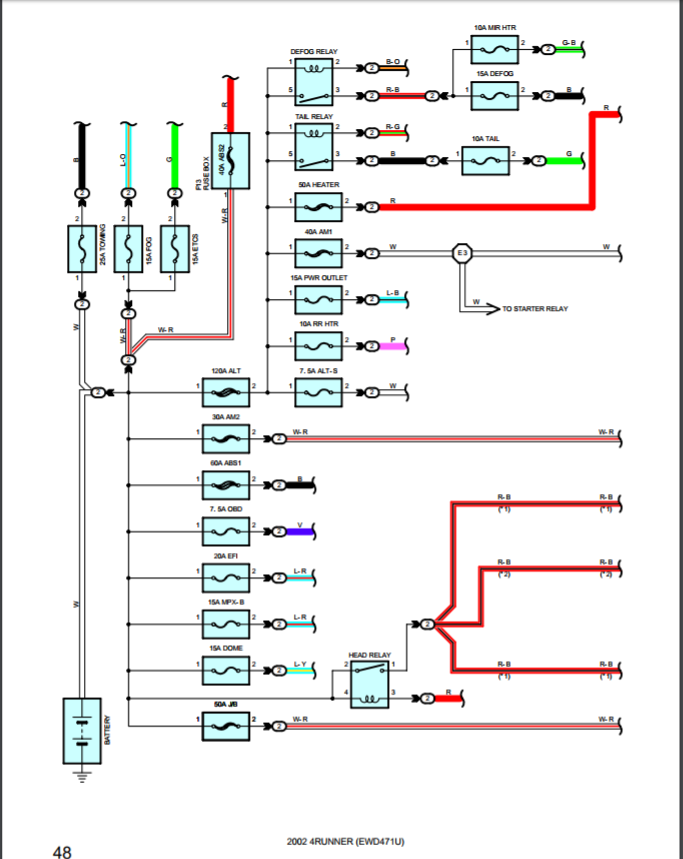

I don't have an FSM or electrical diagram handy, but those two connections are where the vehicle's electrical system receives incoming power from both the bat and the alt - I suspect the little wire on the lower bolt is what powers the constant hot circuits that would support the ECM and Radio presets, etc.
If someone has more accurate info, please chime in.
Sounds really logical to me. I'll test it shortly, thanks again for taking the time.
Well, the alt. only produces power when the engine is running, so the big bolt only has engine-off power with the engine off because the little bolt backfeeds power through the 120A ALT fuse to the big one. Pull the ALT fuse if you don't believe me (not easy to do).
The small bolt feeds the busbar that goes to all the key-off power circuits, including the EFI fuse that feeds the volatile memory in the ECU. The headlights are at the far end of that bar, so they are a good load performance indicator of key-off power.
So basically, if headlights work with engine off, you can forget using a voltmeter on those bolts in this case. You do want to check voltage at both ends of that EFI fuse. If fact, I'd swap in a new one, just to rule out the possibility of a partially burnt one that breaks contact occasionally, and THEN check both ends.
So bascically, if it passes the headlight test and the EFI fuse test, I'd concentrate on the ground side of the circuit.
