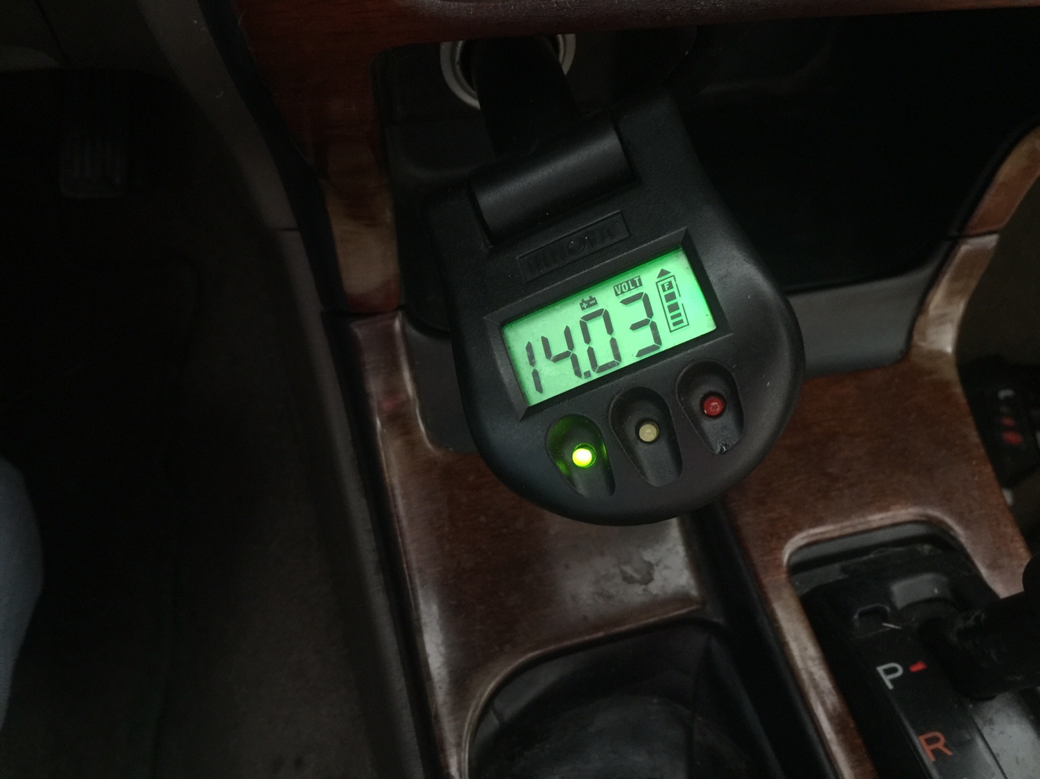

This is voltage at 38f outside and driving a while. Lights and fan on speed 2 while driving.

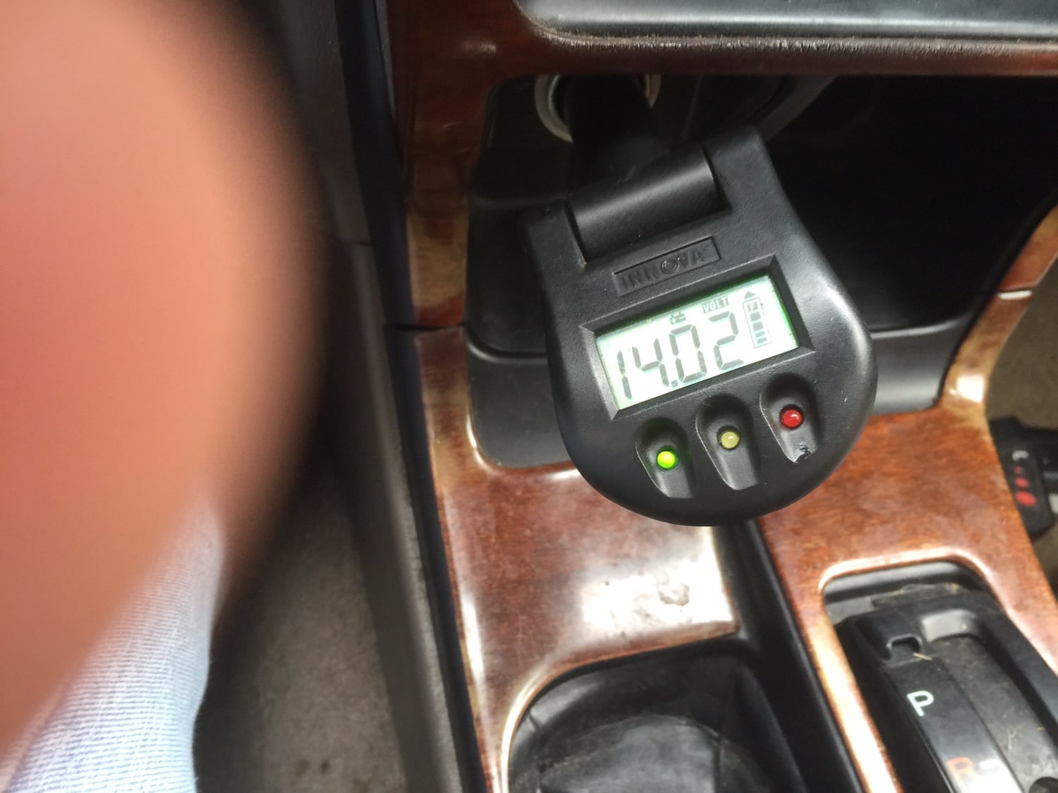

This is at a stop with brake applied and lights and fan on speed 2.
