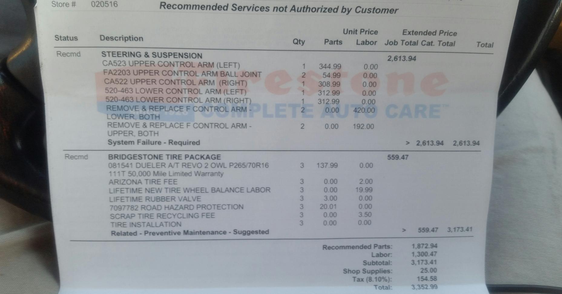

any one used these. https://toyteclifts.3dcartstores.com/mobile/Control-arm-bushing-kit_p_87.html
Ive pressed in poly bushings into my steering rack before, since i can actually get ths control arms off the truck it should be a piece of cake compared the that.
f***ers at firestone wanted to just replace my upper and lower control arms because they said the bushings were bad. I know the ubj boots are torn and squeak, but there is not play in the suspension, except the itres could be done.
also as a side note, im thinking about making a rig that holds my bottle jack so i can use it as a press for bushings and other things, anyone done that before. i think this is what you pretty much get from harbor freight haha.

pretty sure i can beat that price for upper control arms ect. If you want come by my shop and i can look at your front end and tell you what b you really need replaced. You can shoot me another pm to if you want.
Wait, are you replacing bushings because you think you need to based on Firestone's recommendation, or because you want to even if you don't need to?
Firestone's got one F-upped business model. Brought my T4R in for an alignment several months ago. Told me I needed a new ITRE due to excessive play. I made them keep it on the rack till I got there and asked the tech to personally show me and he couldn't.

Yeah im not just doing it because they said, ive also noticed a pull to the left when braking, and when i turn the wheel i can feel a bit of play. also wheb i did my ball joint the other day, i noticed the rubber looked old. so its a combination of things. but for $50 and a days worth of work, i think ill give it a shot.
