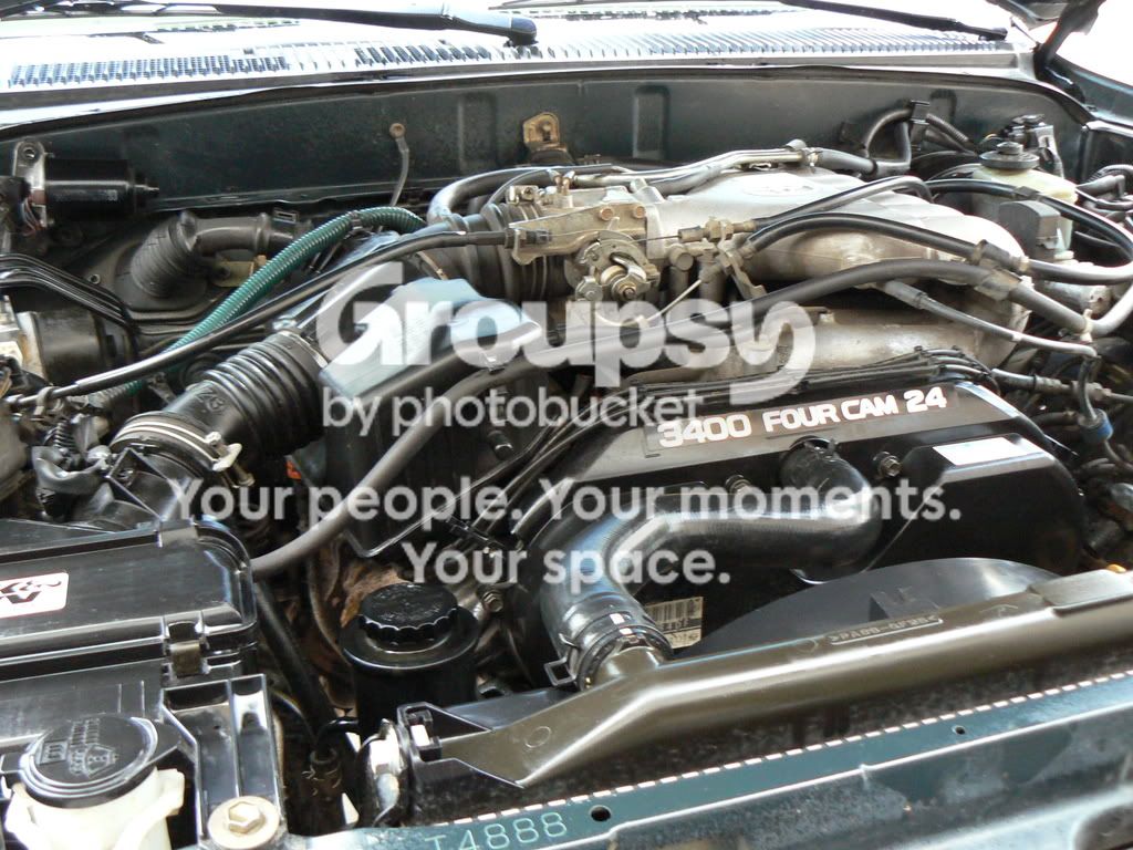

I just use the regular pressure and never pull the trigger and spray as I'm leary of water getting where I don't want it but most of the time I clean the bay at home. I clean mine at least several times a year and after off road trips which helps keep buildup down and subsequent cleanings are easier.

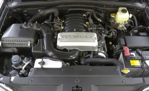

I spray mine down in and around. I have a V8 and i don't see if any wires other than the battery. Everything is pretty much hoses, plastic, and metal lines. Even the spark plugs are plastic/rubber covered tight in a slanting position. If i had a prob, i'd be first to post here.

Wow those are some clean engine bays:wow2:! Mine is usually stained by all of the red clay we have here in the Carolinas as is the underbody. Unless i do a real good cleaning and detailing of hoses and everything i can reach. I do clean it out after some wheelin with water hose and simple green solution but i am extra careful now. Not to make you worry but when i cleaned out my engine bay last November i got a squeel that stayed with my vehicle upon start up to engine off. This has only happened to a handfull of people with FJ's and V6 engine's after some water crossing/ mudding/cleaning. No real problem just the noise. I brought it in to the service department to look at and they replaced the idle pulley system under warranty. These are the bearing type wheels behind the radiator with a belt on them. When i asked them what could of caused it they told me they just went bad like it was no big deal. I might of sprayed a little to much wawa through my radiator to make sure i was getting all of the mud and stuff out. Not sure but i use and used Simple Green solution diluted with water, a little soaky soak and a blast of water here and there and you should be good. I cover up the battery/fusebox/master cylinder with a plastic bag just to be safe. i then use a paper towel or shop towel dampened with water to wipe around these areas and to help dry off everything. Take it for a spin for a minute to get some air through there. Hope that helps.
