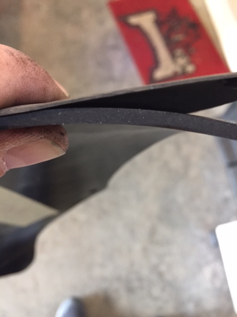

I got mine from Rad Rubber Design and have been very pleased. They're much thicker than the OEM ones, and have held up to everything.
