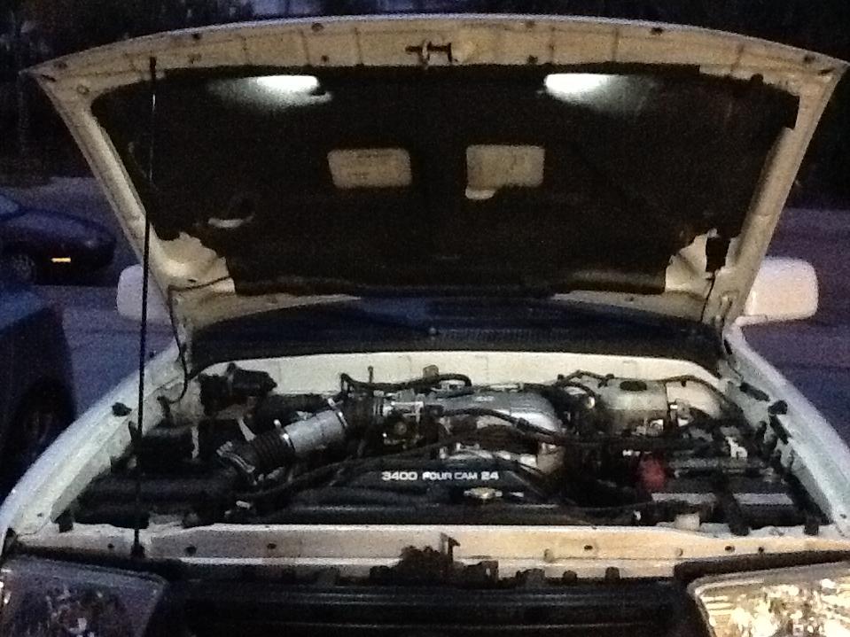

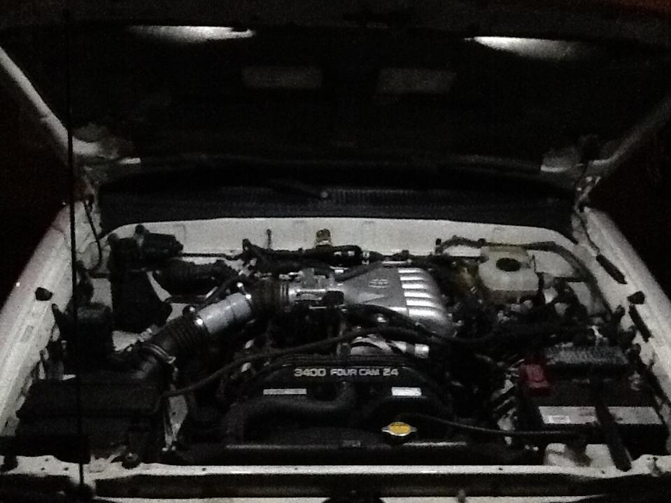

Here's a quick write-up for how I installed lights under the hood to light up the engine compartment. Here is the site I found the lights and the hood switch
It wasn't too hard to install. Recommended materials are:
-at least 2 LED light modules ($10 each)
-hood pin switch ($7)
-about 50ft of 22 gauge electrical wiring ($7)
-2 non-metal washers (plastic works well) (less than $1)
-3/8"-24 thread nut (this is a finer thread- 18 doesn't work on the hood pin)
-Rubber stopper ($1)
Total cost after shipping from Oznium $42. I'm sure you could find materials for cheaper.

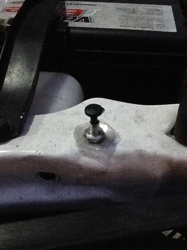

Find a hole where you can install the hood pin switch using the non-metal washers and nut. Note: be careful how/where you attach the switch. Bad things happen if the switch gets grounded. I had to drill a hole out a little to make the switch fit.
I attached a rubber stopper on the hood right above where the switch sits because the hood didn't actually make contact with the switch. You can always trim the stopper so the hood doesn't sit too high up when closed.
Install the LEDs wherever you want. They have a sticky backing and seem to stay put very well. Use the 22-gauge wiring to wire a ground and positive. I used the exposed terminal inside the fuse box--just loosened up the bolt, wrapped it around and tightened back up. Each light also has a ground wire. Find a place to ground each wire.
When wiring the switch, one prong needs to be contacting power and the other needs to be contacting the positive wire from the lights (both lights can feed onto the same wire).
