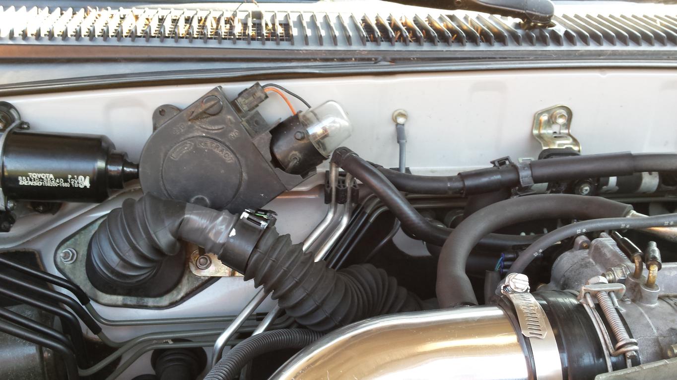

so today installed my ...engine compartment plus light. its nice to have a light at night in the engine compartment
I call it "plus"
plus because it has a long retractable light, long retractable cord, long enough to reach around from where it is mounted in the pass side engine compartment all the way to the driver side rear wheel plus to the center of the rear bumper, so nice at night when you have a flat or something
it has a manual on / off switch
next I want to switch it to a brighter led bulb
so it comes off a mid 90's cheby truck, you can find then on gmc and chevy full size pick-m-ups. they will be on the pass side of engine compartment
when I go through wrecking yards I always look for these. Ive put them in my wifes Volvo, my bmw, my sons Tacoma, my sons dodge diesel and my sons pilot
wired it to the positive post with a in line fuse....works for now, maybe there is another positive hot wire near by, but wanted it to work even with keys out
pic is before I cleaned it and I drilled and mounted it..just hunting for a place for it to fit, could only use two of the three mounting points, but my last one had one broken off anyway, so I don't think its a big deal if your careful with it when winding the retractor wheel

did not think of mounting to the hood, that would have been a good spot too, maybe even better for overhead light in the engine comparmtnet
Yes, that's where it was mounted when I took it out of the Jeep, and it works great as a hood light in that spot.
I also forgot to mention that it has a built in mercury switch, so it knows when you close the hood and the light turns off by itself! You don't need to add pin switch! Did you know that?
The GM/Chevy ones have a lever for on/off, no mercury switch. The last time I picked 2 up the guy at the register didn't even charge me for them. A lot of the little widgets I get are free, they don't seem to be interested in looking it up to figure out a price.
