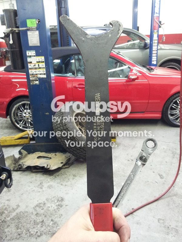

Two wrenches help sometimes, but it can be a bit of a hassle to do. The best way is to get a fan clutch tool that's designed to hold it.
ClutchFanTool_zps420006c2.jpg~original
Picture came from- http://www.toyota-4runner.org/4th-gen-t4rs/130732-2uz-fe-r-r-t-belt-water-pump.html
Short of having fancy tools you can buy a cheap strap wrench from Harbor Freight or wedge a narrow long screwdriver between the bolt heads. Obviously the tool blackworks shows is the optimal way, but unless you want to spend $50 on a tool you may use once it may price you out of it.
This is only $5.99 and will get the job done: 2 Piece Rubber Strap Wrench Set
