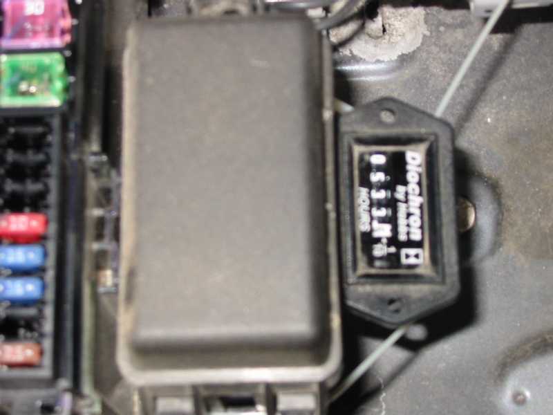

Had several enquire about this "mod" so here it is (very simple.)

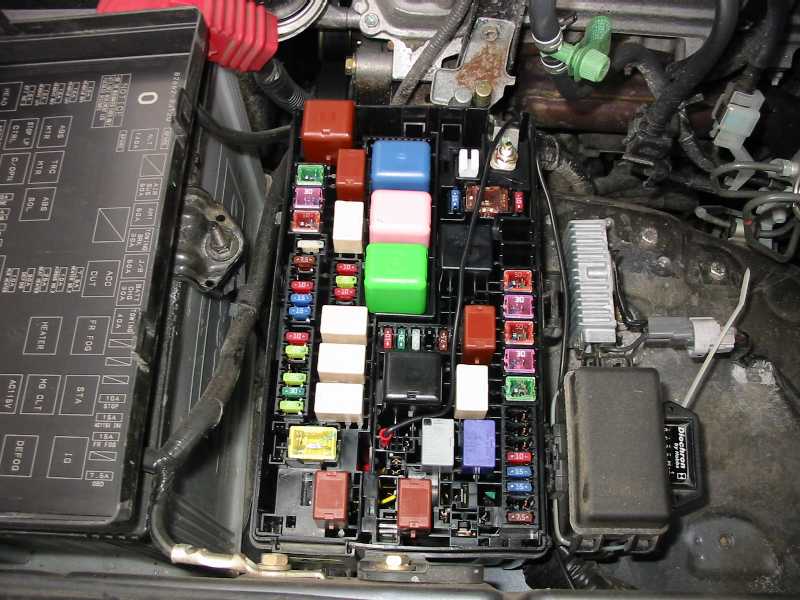

Picked up a generic 12V analog hour meter at an automotive/tractor supply shop (TSC in Canada.) Tie wrapped it next to the relay box on the rear of the engine bay fuse box.

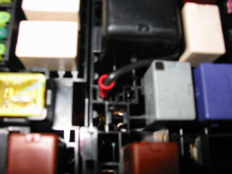

Put a large crimp connector on the negative wire and bolted it with the others at the ground on the fender (next to the fuse box; bottom of the pic.)
Put a small spade connector on the positive wire and ran it to pin #2 on the unused (but working) 115V AC relay slot. The meter is only on when the ignition is on so I get almost true engine time (just for curiosity sake.)

That is simple and easy enough! Thanks for the info!
This would give a bit better info on usage than a mileage reading...factoring in those time when you just sit and idle.
Plus a bit of a "coolness factor" especially if it was installed in the dash!

Lets me calculate an actual average kmh (mph) for maintenance or on long trips (haven't bothered to compare it to the dash readout.)
Would have liked to put it inside but the analog has a noisy timer click to it. I might break down and get a quiet digital but haven't really looked for one. This works for me.
