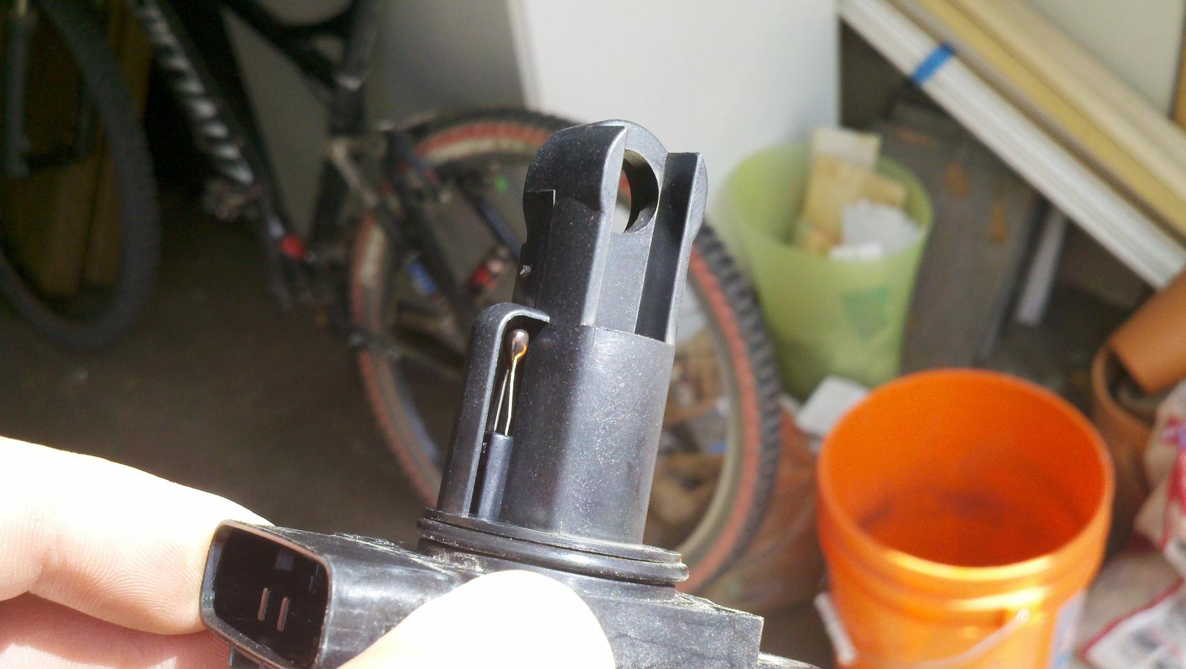

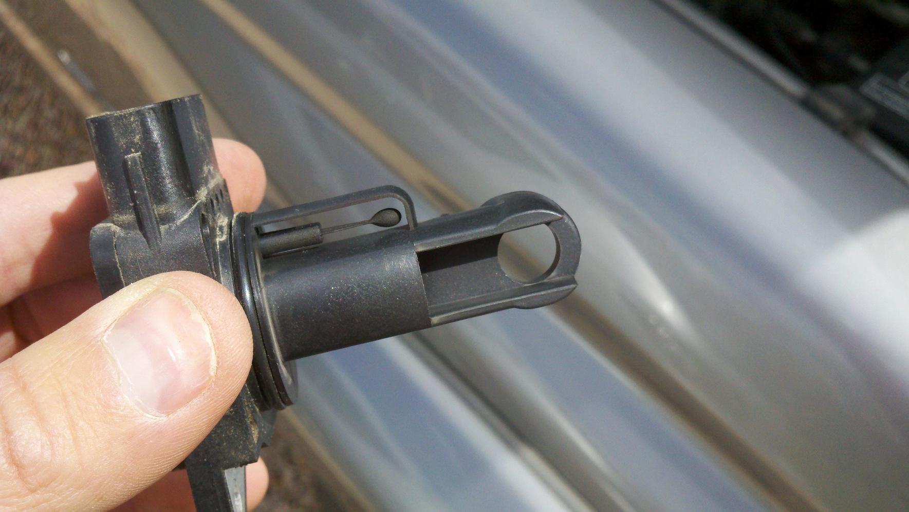

Cleaned the MAF, it was real dirty on one side, but the issue did not go away! I put a Chevron fuel injector cleaner in the tanks when I filled up yesterday, we'll see. The CEL flashed times in about 2 seconds as I got on the highway on an uphill onramp, but hasn't come back since. If the CEL doesn't stay on, would a dignostic show any codes?

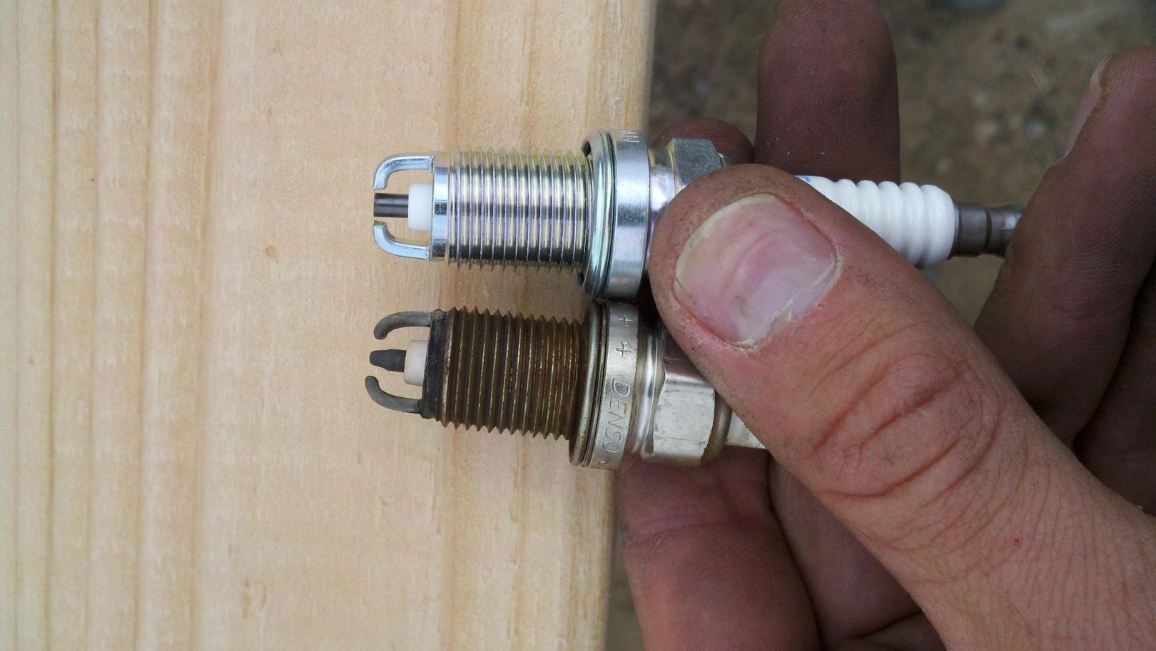

Replaced the spark plugs and wires today with NGK equipment. I think it solved the problem I was having, didn't experience any of the sputtering/lag issue on the 15 mile drive home. Crossing my fingers! All the plugs I took out were Denso, so apparently the plugs had been changed before, or at least three of them. Below are pics of the MAF before and after cleaning, and one of the old plugs next to the new one...
