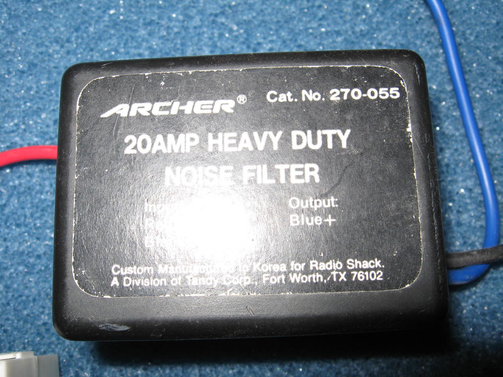

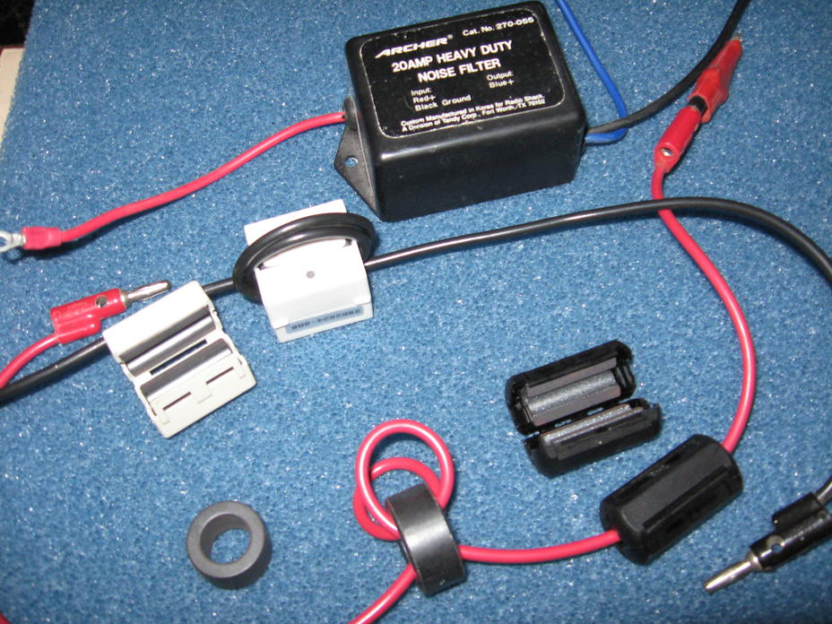

Here are some ferrite type filters and a LC power line filter.
I use them in various combinations to eliminate power line noise (alt whine) and RF feedback with various 2 way radios in my vehicles. Another is a feed-thru cap, couldn't find one to take a pic of.
