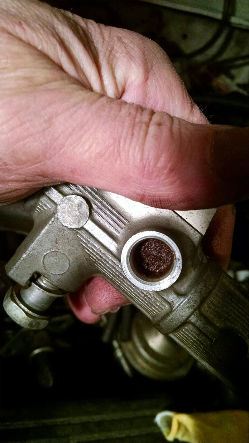

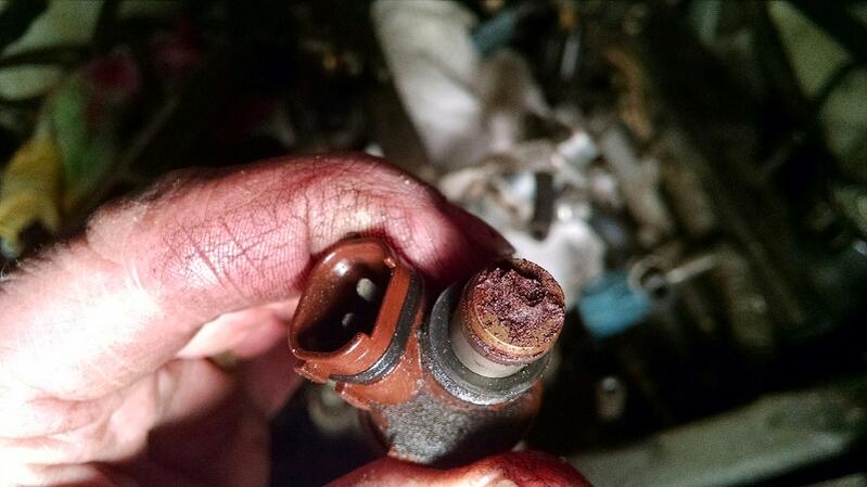

Clogged injectors x 3. Here are pictures. I'm taking them in to an injector service place. Next question... With this stuff showing up on the injectors and rails, it has to be coming from somewhere. Even though the gas drained clear, and I plan to change the fuel filter, should I drop the tank and take a look in person? How far should I tear apart into these components?

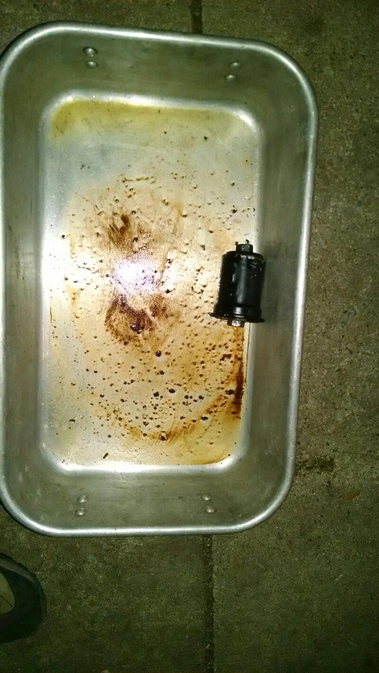

As I work my way backwards, here is what I found in the Fuel Filter.
Note to any concerned, a 14mm Crows foot on the end of some 3/8 drive ratchet extensions and a u-joint makes fuel filter removal way easier.

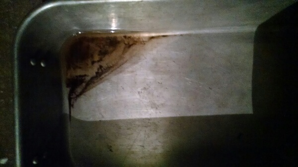

Tonight I cleaned out the fuel rails. Here is a shot of what backwashed out of one side. I got the injectors back all cleaned and flow tested with new O-rings and grommets. I also back flushed the fuel line. Tomorrow it's supposed to be warmer so I anticipate putting the intake all back together and dropping the tank.
