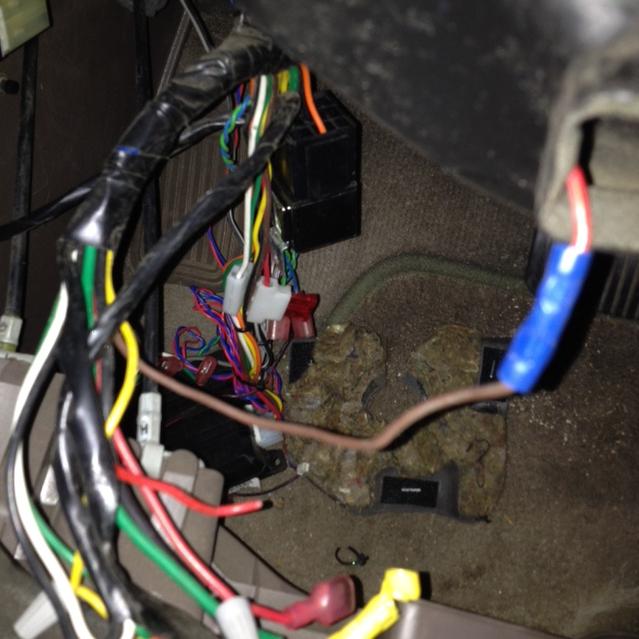

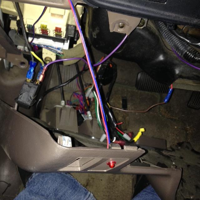

This is how the driver side was left for me when I picked the truck up. I am going to have to figure out how to put all of these wires back. I don't think it should be too hard but we will see I guess.

Typical mechanic couldn't figure out the Alarm. Honestly, not his job. So he bypassed it (Check to make sure the alarm harness, is still plugged into the alarm brain).
