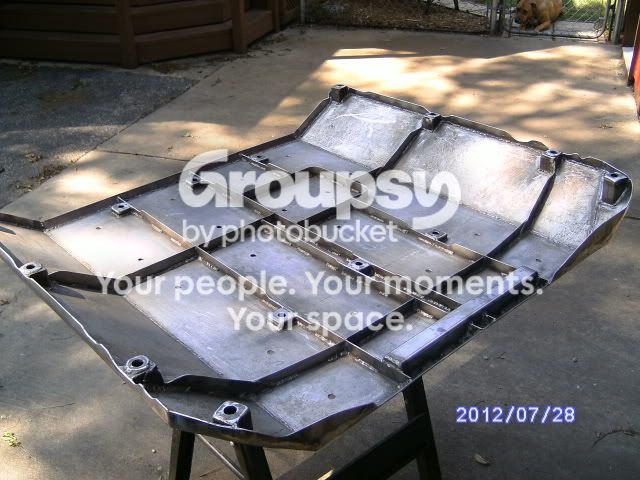

OP: I did exactly what you are describing when I built my custom skid plates.
Front skid:
Belly skid:
PICT1573.jpg~original
I only used 1/8" thick steel for the skidplates, but added ribs in strategic locations on the inside. This also helps keep the skids very light. The other thing I did (which I think is extremely important) is to use multiple mounting locations. Let the truck's frame/crossmembers take the load as much as possible.
Most aftermarket skids just have a few mounting points on either end of the skid, with a large span of unsupported skid inbetween. With multiple mounting points it spreads out the load. Of course the down side is that it takes a little longer to remove and install the skids.
^^ Damn homie, that's a nice skid plate! Have you tested it yet? I'd like to know how the 1/8" steel holds up with that design.
The skidplates have held up great for what I use them for. I don't do too much hardcore rock crawling, but I've hit a few stumps and logs with them in the woods. Just scratches, no major damage.

Those are amazing and exactly what I’m looking for. Are you in the market to make another set
QUOTE=Bandit Runner;1963087]OP: I did exactly what you are describing when I built my custom skid plates.
Front skid:
Belly skid:
Most aftermarket skids just have a few mounting points on either end of the skid, with a large span of unsupported skid inbetween. With multiple mounting points it spreads out the load. Of course the down side is that it takes a little longer to remove and install the skids.[/QUOTE]
