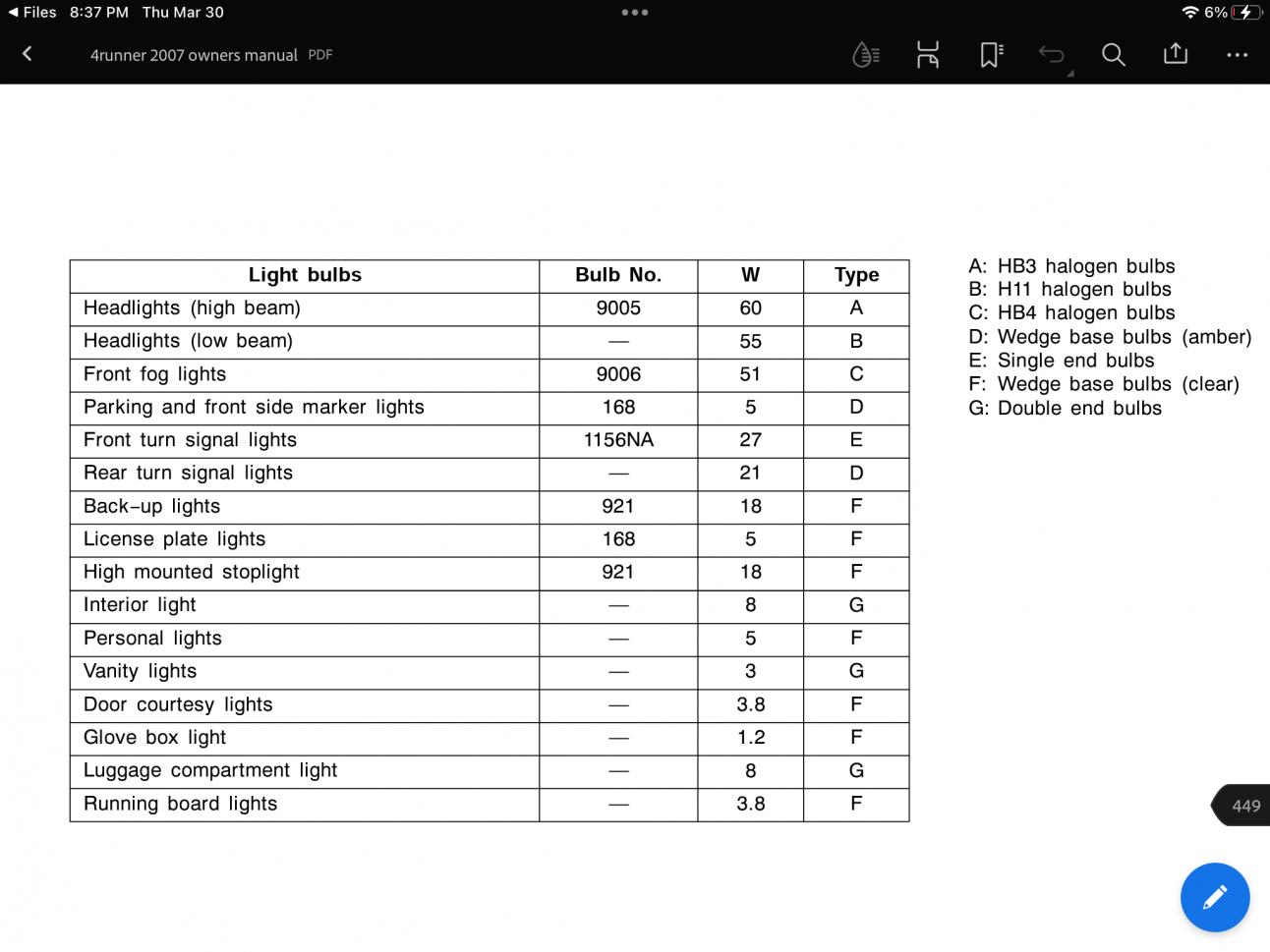

Getting ready to install some squadron sports and would love help with the wiring. Wanting to wire to factory wiring
