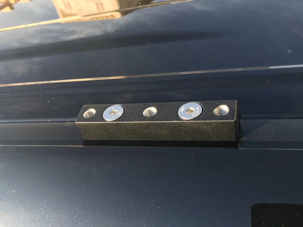

Take a look at these while ignoring the 3 empty holes (pretend they're not there and that it's just a solid block of aluminum with 2 holes): https://images.squarespace-cdn.com/...RKOCd3Esfzua9QhbWww/IMG_1332.jpg?format=1000w
Those are from a place called greenlane offroad. They don't sell these but if you know a fabrication shot that works with aluminum, you could have them make you something. You only need the two holes that bolt directly into your vehicle.
Big ol block of aluminum. You can easily seal the top and bottom with a 1/16" thick sheet of high temp silicone that:
a) sits between your vehicle and the spacer and
b) sits between the spacer and the mounting bracket of the prinsu
Add lots of butyl on top and bottom of the contact surfaces. Use a butt load of loctite on the bolts to seal up the bolt threads that screw into your vehicle.
Bam. Done.
The spacers provided from prinsu blow chunks. It'll indent your roof and/or possibly damage the paint and/or painted sealant along that channel. They'll also act as cups that will hold water until it either dries or finds a pin hole in the silicone and leaks in your cab. Get rid of those and hit up a fabrication shop for properly sized and pre-tapped blocks of aluminum. Hit them with some of your own spray paint if you want.
