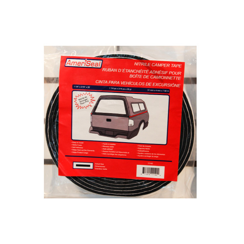

I have also had good luck with that thick, closed cell foam strip you get for sealing camper shells onto truck beds. I had a customer who's Tacoma had a rack installed with no sealant what so ever and the inside was soaked and moldy. The stuff is very squishy and seals well, similar to some of the waterproof foam Toyota uses to weather seal some exterior parts. Something like this stuff:
Thanks for the tips! the LFD roof rack doesnt have those stupid tube spacers. There is an actual block that is used to fill the gap between the weather stripping, and provide a solid mount for the rack. So hoping with the sealer we mentioned should provide a nice even surface to seal everything.
