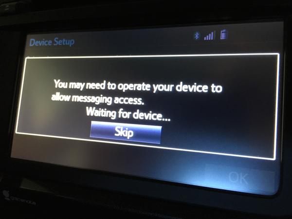

Text messaging and entune have been a bit finicky for me. So I wanted to post this as a potential solution for others (albeit a slightly inconvenient workaround) and also to ask if anybody has had the specific issue I'm having and came up with a permanent solution. I've been through a few entune threads and haven't seen it framed up exactly like this, although I could have easily missed it so sorry if this is repetitive.
Almost every time (>90%) I start up entune the phone will connect fine for all functions except Messages. I can still get a message alert but it will not play it/read it over the speakers (if I'm moving) or display the text on the screen (if I'm stopped) like it's supposed to. When I go to the Message app on entune, I get this:
even though I've had it connected and set up many times before.
If I hit 'Yes' it just shows this and does nothing and never connects:

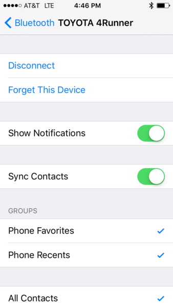

Now if I go to my phone's bluetooth settings after starting up entune and after my phone has connected to entune, and then cycle the 'Show Notifications' button, I can then go to the messages app and set up messaging and it will connect and work just like its supposed to.
But I have to do this almost every time I start up entune after it being shut off.
So has anybody had this or have a fix? I have now used entune with 2 different iPhones (a 5 and an SE) with two different versions of iOS (8.something and 9.3). I have not tried to get any kind of entune update yet, but vehicle's only a couple months old so I would think the entune version would be okay.
For those that have the same problem and haven't found a solution. Cycling the 'Show Notifications' button in the phone's bluetooth settings and then setting up messages again has worked every time for me. I just have to remember to do it when I get in the truck and start it up.
