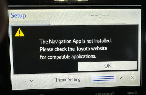

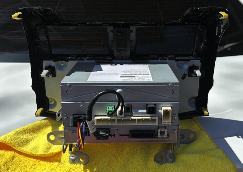

I have a 2016 with navigation and awful Entune 2.0.
Found a non-JBL/Navigation Entune 3.0 from a 2021.
It included the special coaxial cables to connect the navigation. I also bought the special harness from autoharness. However, when testing I get a message stating navigation App not installed! Yes, I know it is useless, but I want this to work properly and I use the built-in map as I drive on curving roads as a predictive measure.
Is this unit defective? Any ideas what to do? Anyone experience this? Urgh. Never an easy job.

tad surprised that this would happen, I would try the following. I had no issues hooking the head unit i purchased
1. hard reset of head unit , reset back to factory settings
2. check for latest operating software and upload via usb. Even if you have it installed already may want to give it a try.
3. double check correct wiring (not sure if the gps wires were able to be plugged in different connectors) . GPS antenna plugged in?
Ok, I hooked it all back up. It went through a power cycle on its own and now seems to actually work. Whew.
And for Carplay I needed to select some unsuspecting feature (i forget what it was named) and that then let me activate Carplay and changed
the name of the feature to Carplay and that does indeed work now as well.
The App: Remote Connect was asking for a 6 digit PIN...but I probably can't use that feature anyway.
