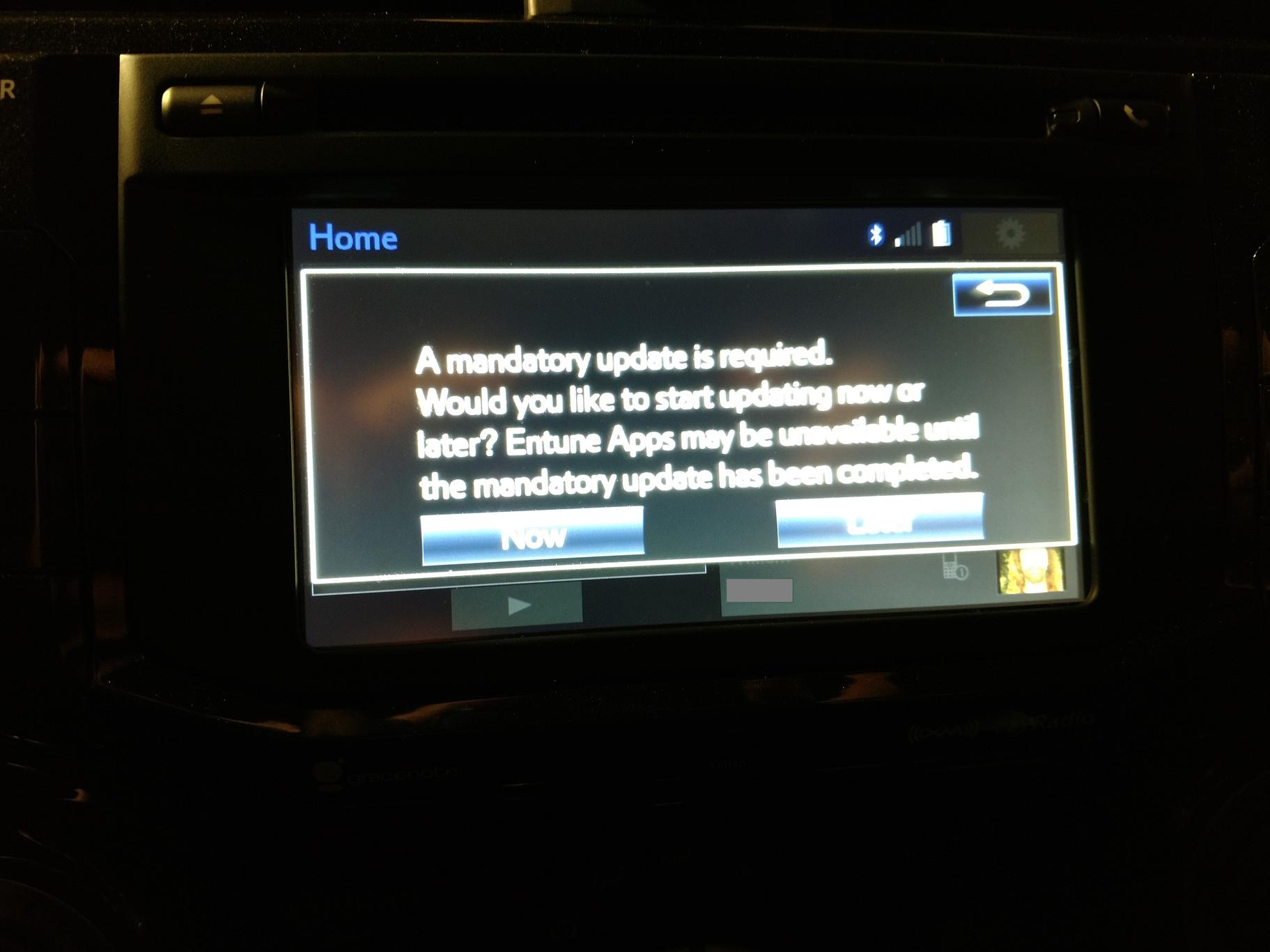

After trying to update using the website, I went for a 5K service and asked the dealer to update it.
When they failed to find a newer update file, I plugged in my phone into the USB port , started the Entune app in the phone and received the mandatory update screen.
The install was uneventful...
