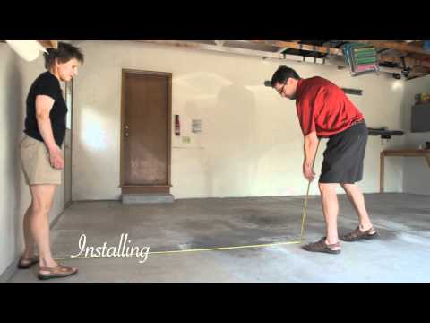

Looks like it can be installed by two dudes in sandals.
