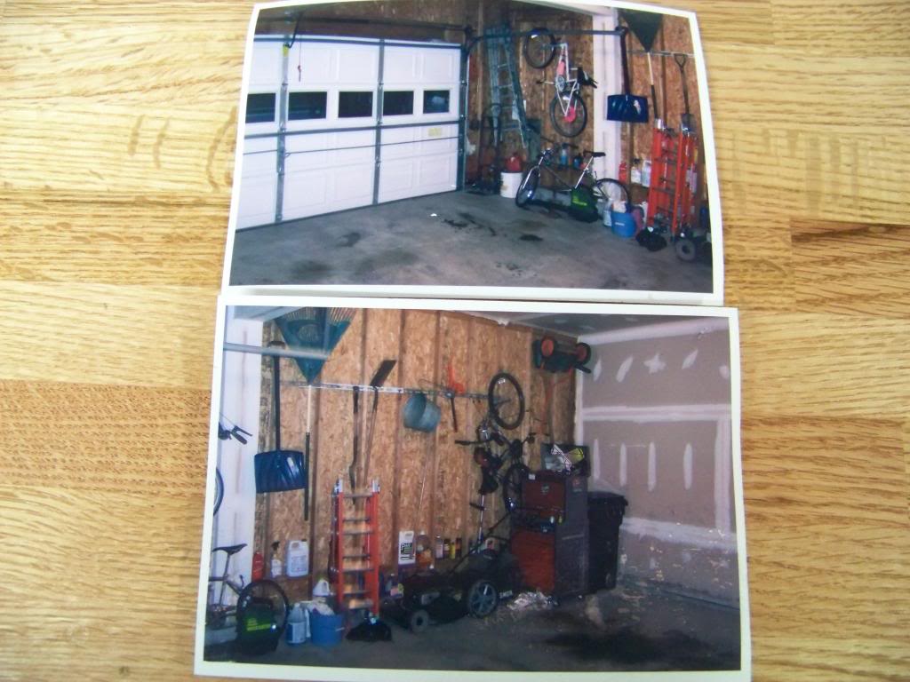

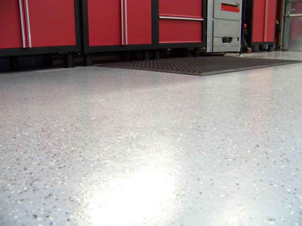

I did mine myself 9 years ago with a kit from Home Depot for $99. I can tell you that prep work IS THE KEY! When I moved into my house the garage floor was typical- very dirty with a huge oil stain in the middle. I cleaned it and pressure washed it for 2 loooong days until I could walk on the floor with clean white socks and pick up zero dirt.
My floor is just as nice as the day I painted it. I have had the truck on jackstands, dropped 5lb hammers on it, remodeled the garage and even spun the tires coming into the garage (there's a big step)- zero issues.
My Garage
Before:
After:
