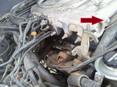

I had a similar issue. It turned out to be a bolt that I had removed to get rid of an unused bracket. It is drilled all the way thru the intake plenum. Lets it suck air and idle like crap.
Yes, that bracket held the EGR modulator.
THANKS! Your pic of hoses shows me that last year I had a mechanic replace the valve cover gaskets (leaking oil) and he must have repluged
the VRV incorrectly! I paid special attention to the routeing decal under
the driver side hood, and re-routed two lines that were on the three metal
tubes in center under intake.
FIXED THE PROBLEM>>>>>>>>>>>>>:wink2::humble:
Hope anyone haveing a similiar problem reads this and re-checks a mechanics work! Whew! Its been a very long year figuring this out!
