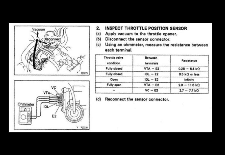

What's the procedure for checking the TPS?

testing the tps
