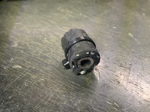

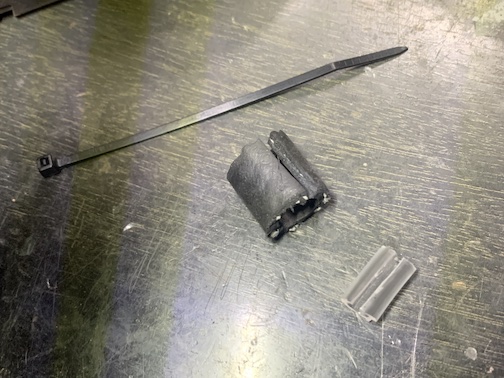

For the accelerator cable grommet, my setup is in the pic below - works fantastic. Just don't have the accelerator cable super tight as the gas pedal is a bit touchy after the grommet mod. A super tiny amount of play in the gas pedal is ideal.
