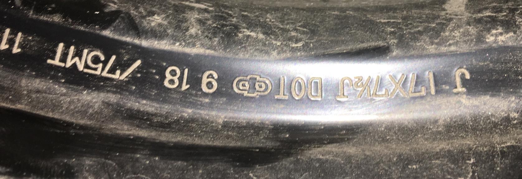

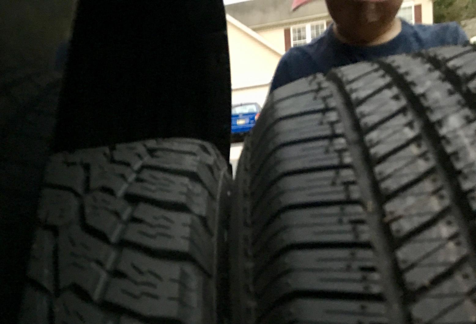

I checked and it looks like the standard spare size. Does the tire really compress this much when installed under weight of truck—see pic?

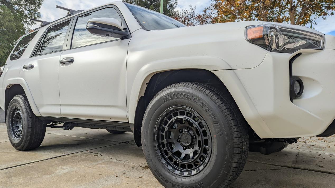

So the wheels never came in and the order was cancelled. I went out to the Black Rhino website to look up other alternatives. I found a local shop with great reviews so I called them, they looked them up and found them in no time.
Their recommendation was to go with the zero offset which I did and so far they've been great. I put them on the stock tires for now and will change tires once ski season starts here in NorCal.
Biggest plus is that I now have a local shop for mods and have an order out for some rock sliders.
