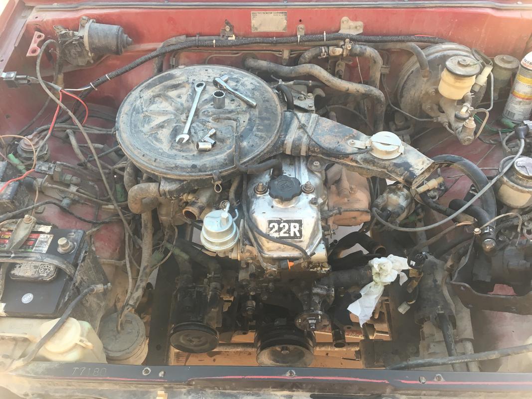

Finally finished the timing chain deal! Started last Friday and just finished it today. Took me so long because of work and it being really hot in the afternoon. In addition to the timing chain, I replace the water pump, oil pump, belts, and all gaskets. This was a good chance to really clean the bay as well because there was a lot of caked on oil and gunk. Also painted some parts to make it look a little cleaner. Runs very smooth now and nothing leaks!
Before:
your truck is an 84 right? seems like you might have an earlier engine in your truck based on your sloped valve cover. the 84 I had that I bought back in 1990 had the later valve cover
I've noticed that too when I started looking at other 22rs. However I would not know how to check and see for sure. It could just have the earlier valve cover.

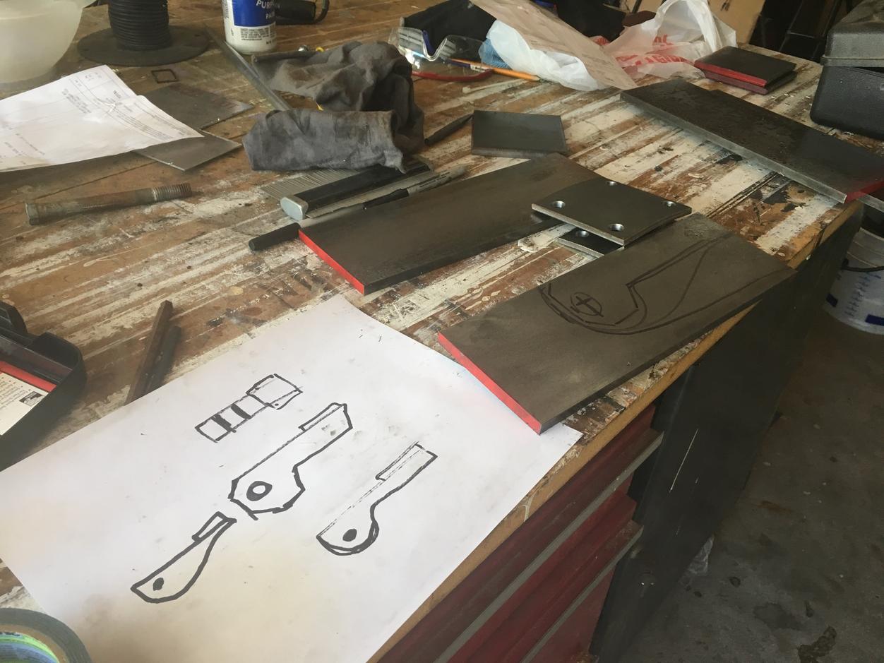

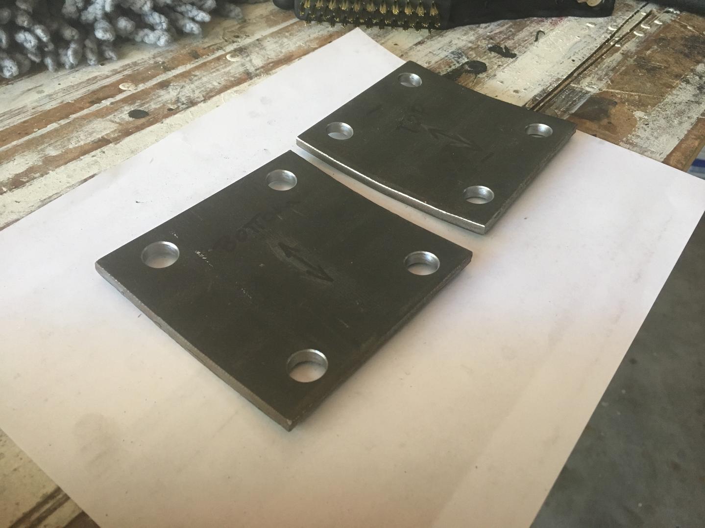

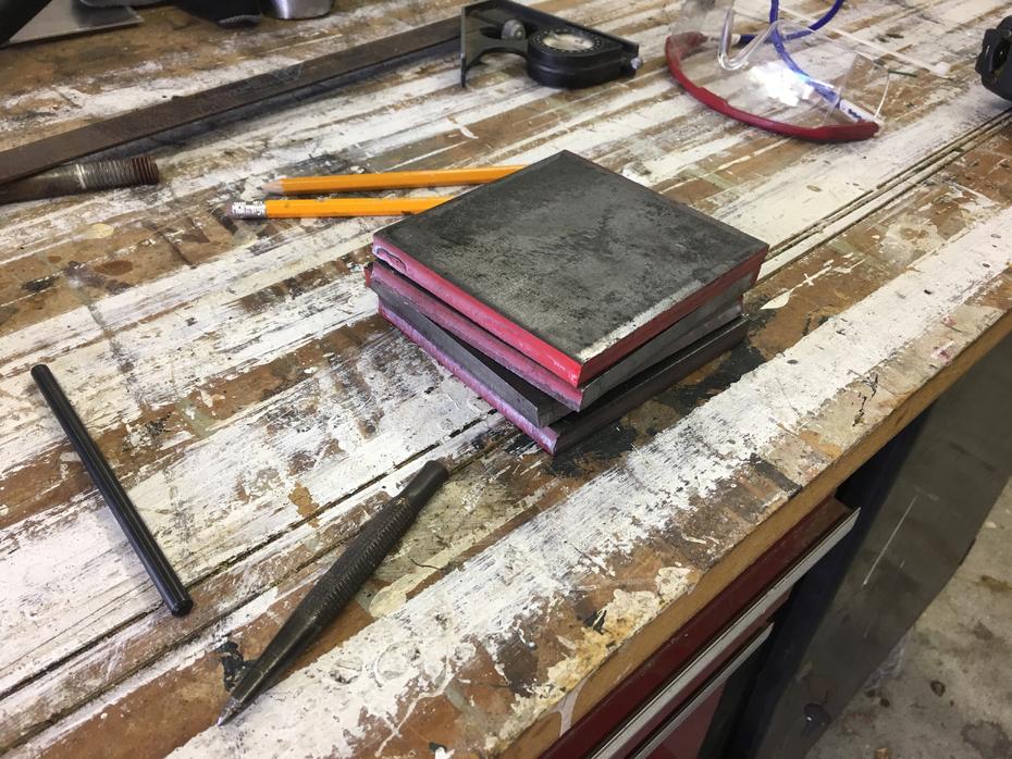

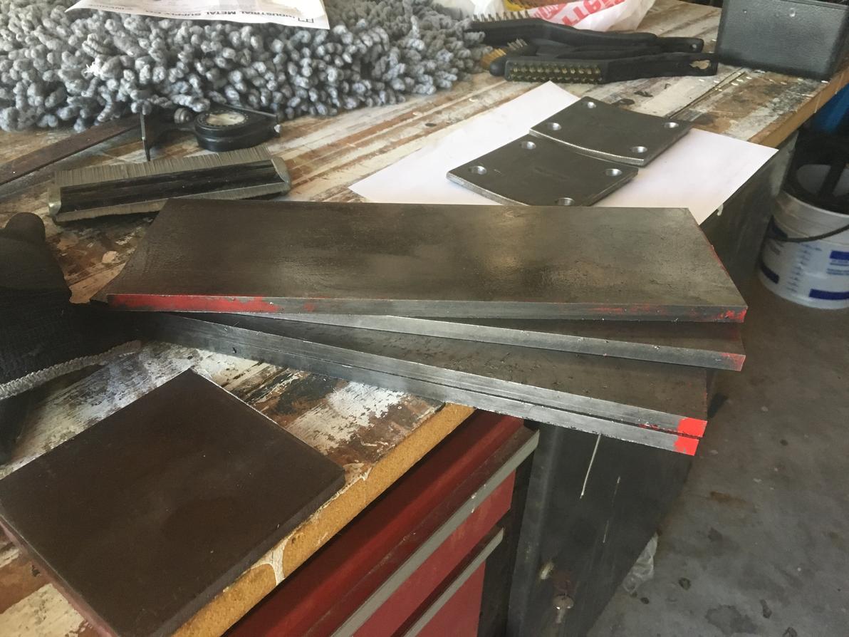

Made some progress on the spare tire carrier retrofit. Cut off the old brackets off the carrier, and started to make the new brackets. Made the plates that are going to be on the outside 1/4' thick and have the plates on the inside be 3/8" along with the hinges. Also going to add internal gussets inside the taillight housing to help reduce stress on the sheet metal. Not much material was made, but I think Ive got the whole thing planned out now.

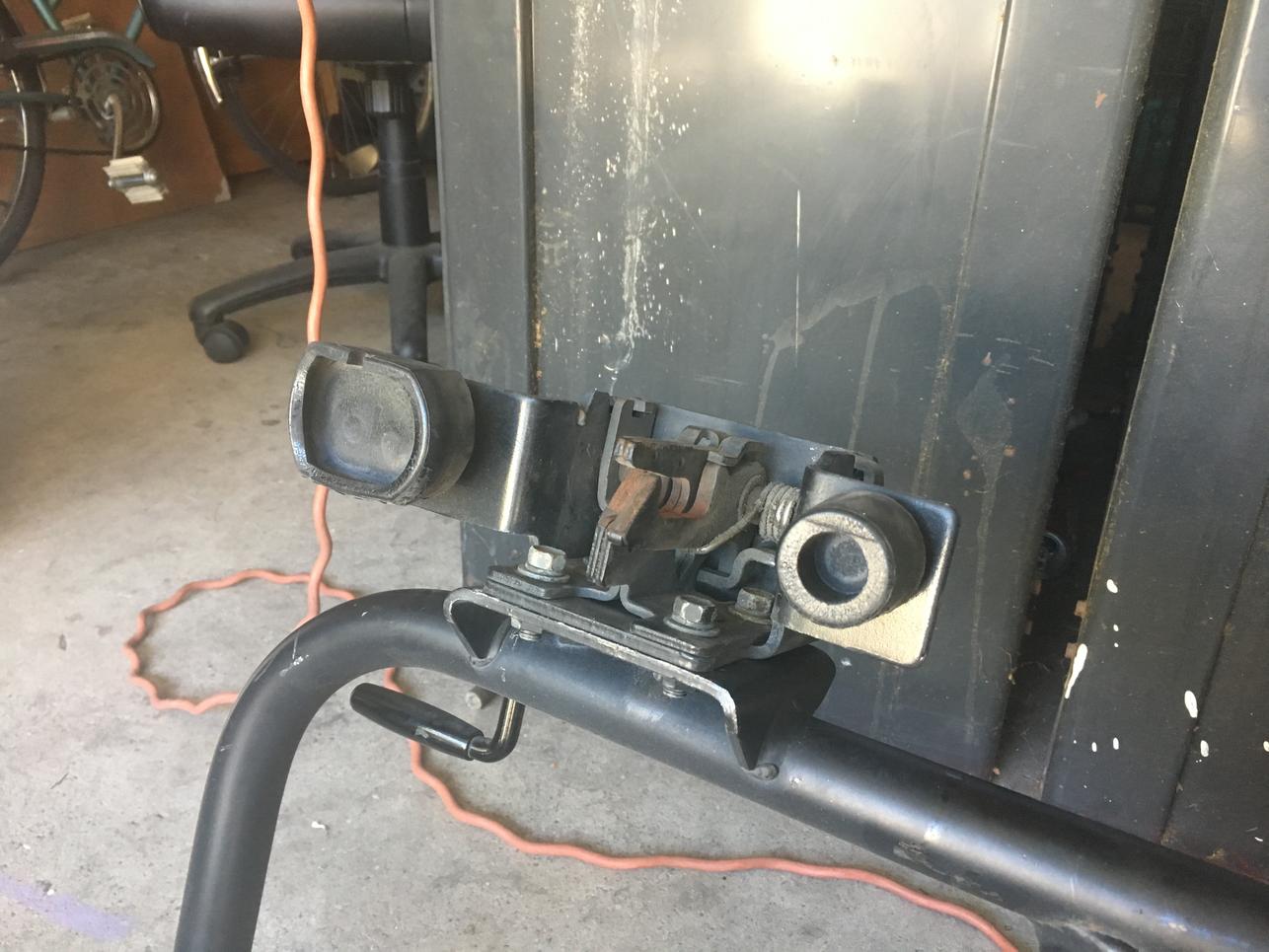

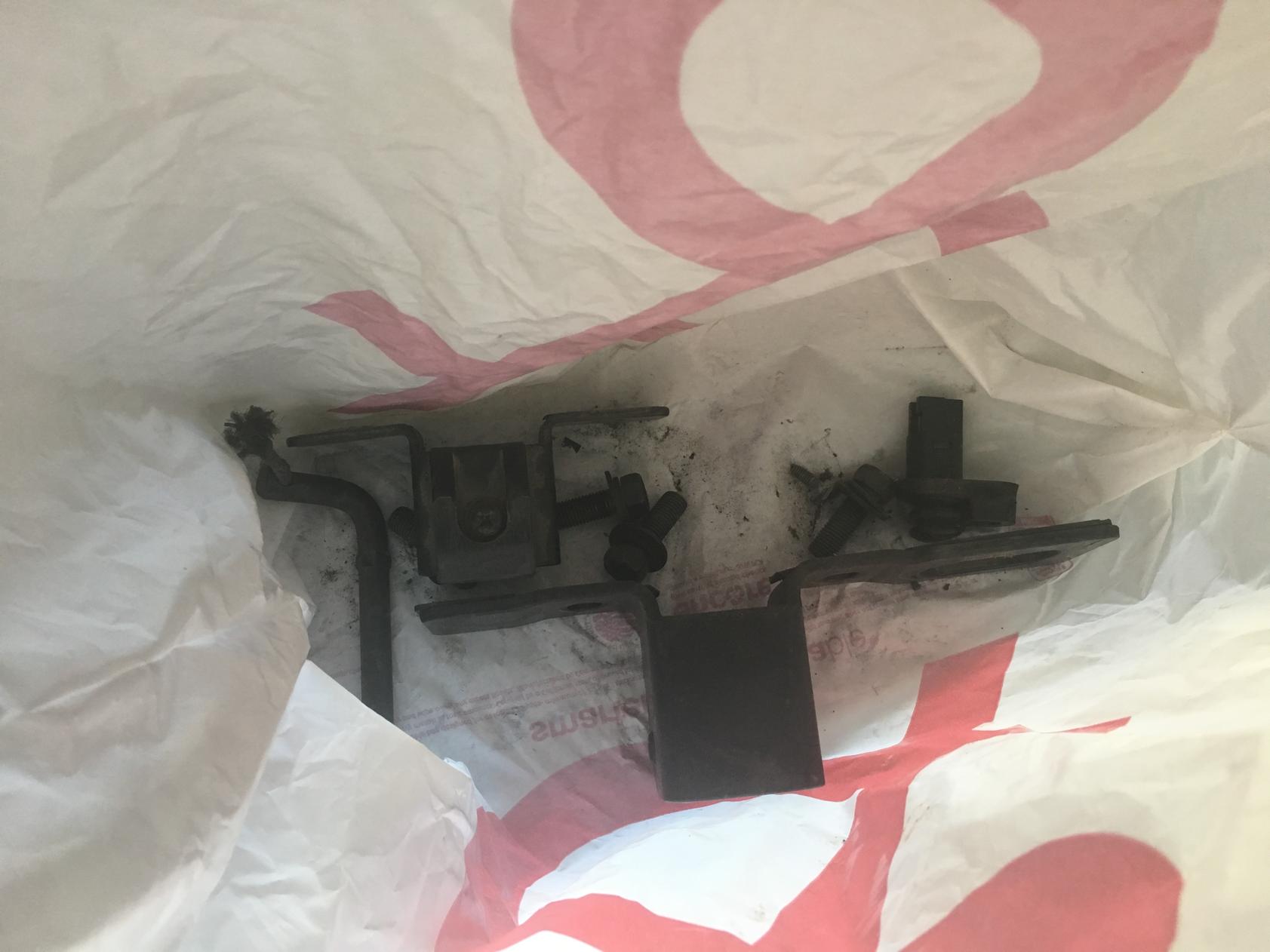

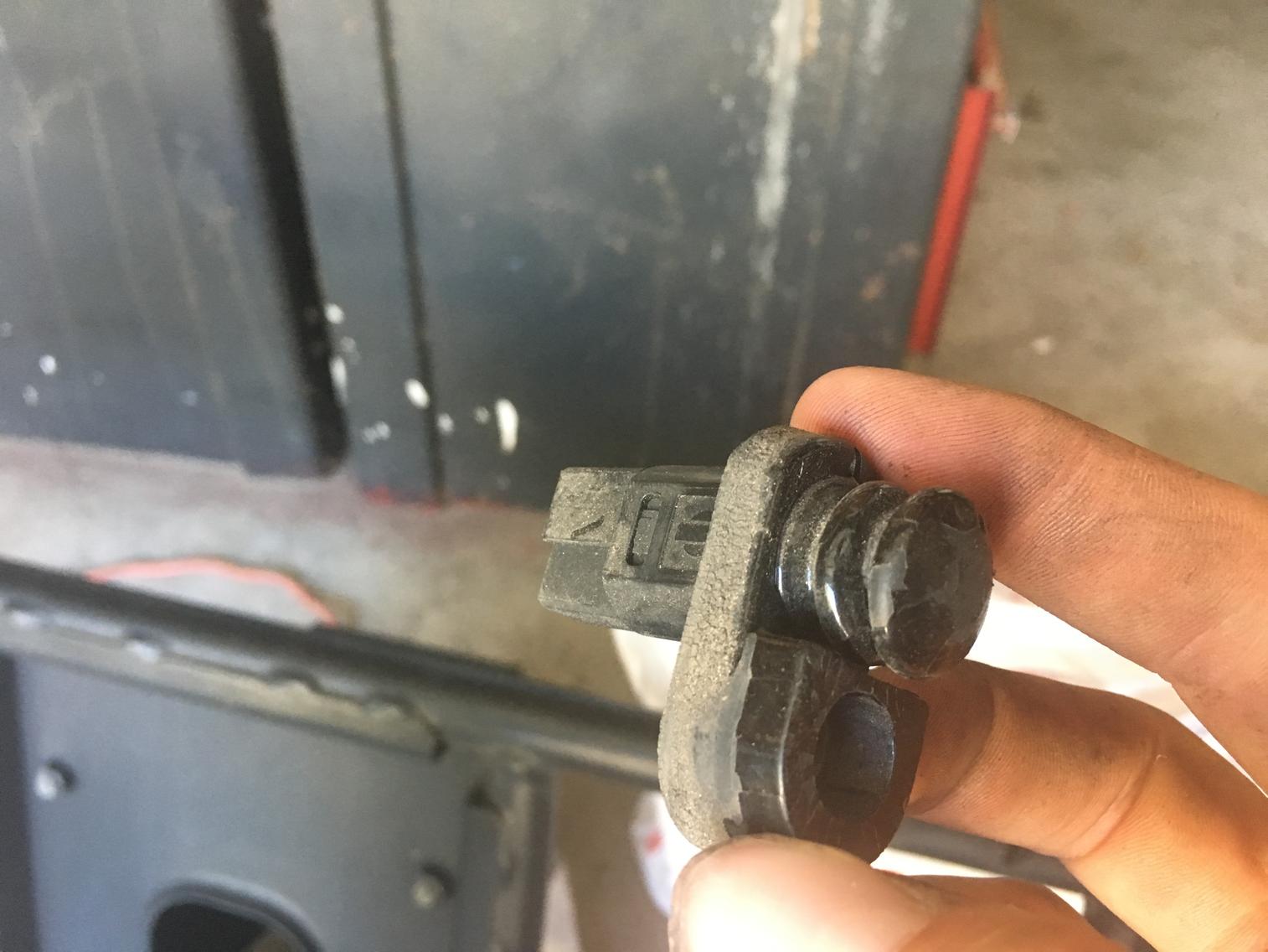

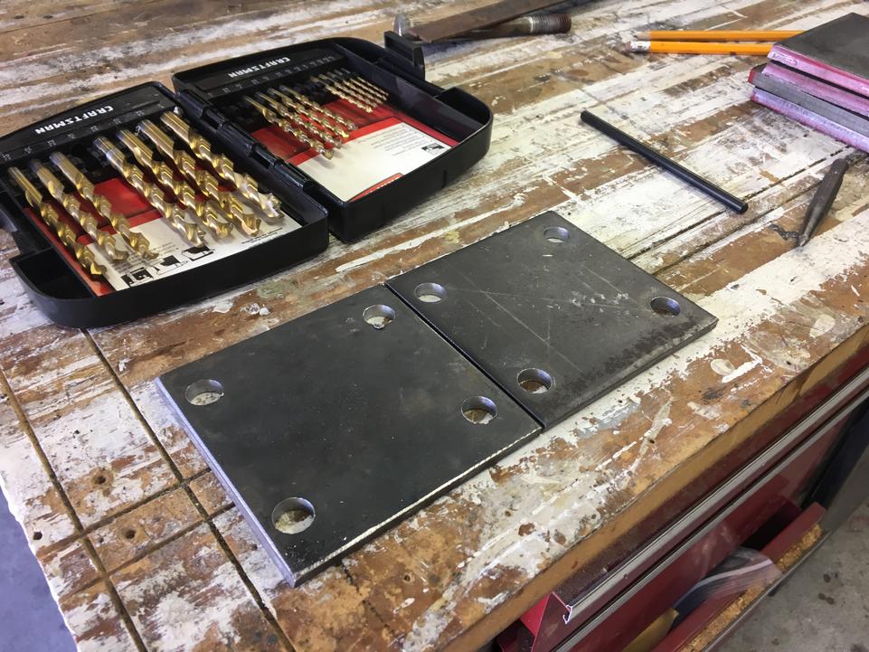

Got some more progress done for the tire carrier. Went back to the pick a part and got the latch mechanism fro the carrier along with all of the brackets since someone already snagged them when I went to get the carrier the first time.
Even got the little button to show when the carrier is open or not, might wire it to a little idiot light on the dash.
As far as the brackets, bent up the outside plates and came up with a design for the hinges. Should hopefully have these welded up by the end of the week!
