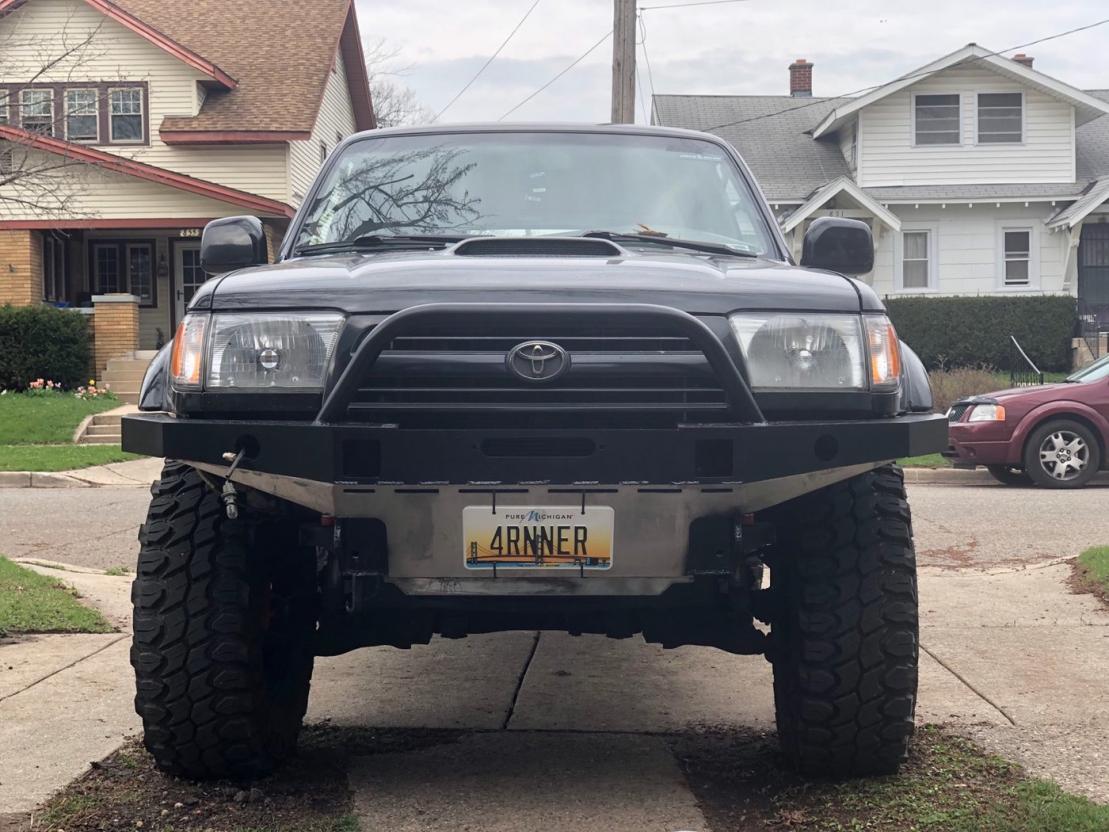

My 99 with 4x4 Innovations front and rear plate. Coated with Monstaliner "pyroplastic", still gotta mount the rear this week if I have time. Then put lights and D-ring N stuff.
Sent from my SM-N920V using Tapatalk

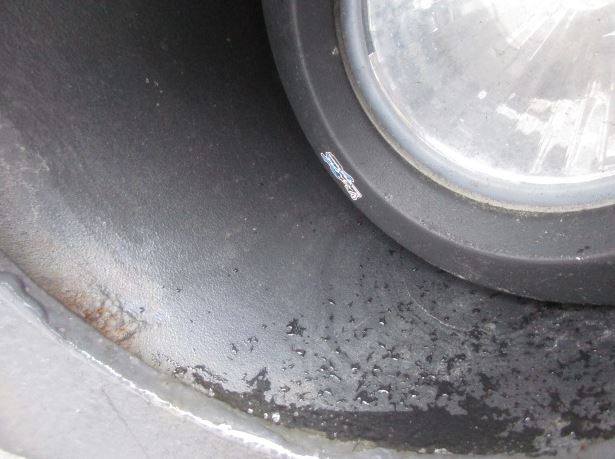

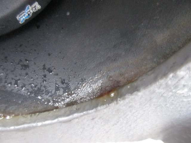

They've been ok considering my usage. I drive a lot of highway miles, so small stones hit it at 80 mph from dump trucks and other trucks. Few chips and places I need to touch up on the front bumper. The rear got wacked by a few things and that needs to be touched up too, but overall good as can be expected. Surface for Monstaliner needs to be scuffed up really good for bond. Chassis Saver really needs to be scuffed up on surface for bond. Both are really hard paints and really finicky on bond. If not a good bond, they can come off in large chips or flakes when hit by something. I went over primer and Rustoleum and scuffed it up good. If you don't you'll have bond issues.
The light buckets, I couldn't get Monstaliner in there proper so it was just Rustoleum over primer. In the light buckets I'd put a small amount of paint bondable caulk, cause there's a small gap there, light buckets are tacked on (at least mine are, not a full fill bead. Hard to spray in gap. When I touch mine up, I'll address this. Here's a couple pics of the light bucket rust bleed out. I rolled my Monstaliner on.
Because of the color you want, if you can, consider a hot galv dip. That would hold up nice, and galvanized will hold up really better than anything and the color is nice with a silver accent truck. I think [MENTION=168172]sleepydad[/MENTION] was one guy that did it.

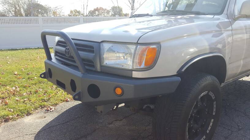

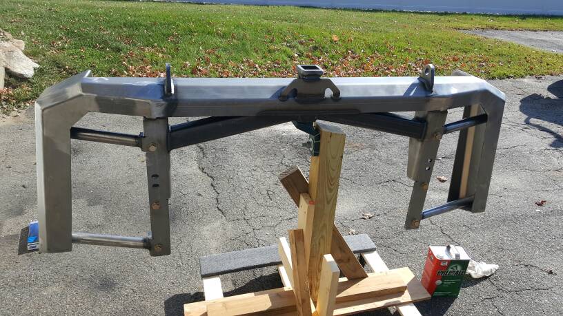

hot dipping is a pain to source but it's not expensive. I did mine back in 2017.
It has weathered a bit but it has zero rust on either the front or back bumper. it was very shiny when I first got it done and it's dull now.
I think this was right when I got it back from the dipping guy
these are hi-res so you can click and zoom pretty good on these images.
<a href="https://imgur.com/UGkQhFG"><img src="https://i.imgur.com/UGkQhFGl.jpg" title="source: imgur.com" /></a>
you can see here as time as gone on it has dulled down quite a bit
<a href="https://imgur.com/uoHLXgZ"><img src="https://i.imgur.com/uoHLXgZl.jpg" title="source: imgur.com" /></a>
it's now on my winter truck so it's getting salt belt punishment and it's holding up just fine.
<a href="https://imgur.com/nm8XpXo"><img src="https://i.imgur.com/nm8XpXol.jpg" title="source: imgur.com" /></a>
a couple of things to know about dipping
1. you need to drill holes in any sealed area, like enclosed tubes. the steel can explode if you have sealed areas because of the heat and pressure changes when you dip something. not a big deal just be aware of that.
2. you can't weld on it after you dip it. in truth you can weld onto galvanized surfaces but you need to have special equipment to protect yourself from the nasty fumes. can kill you if you don't use PPE.
other than that it's a nice setup and I'm happy I did it. again not showroom appearance but for me it's about the utility of it. it's also a really tough finish and takes a beating.
