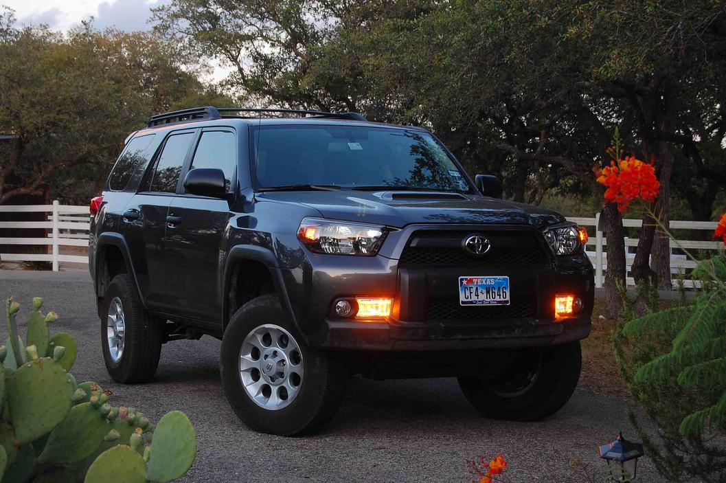

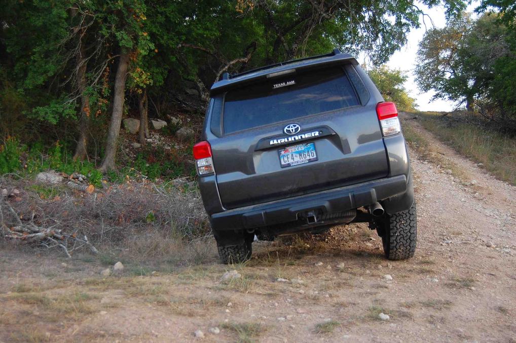

She arrived, October of 2010, completely out of sorts in her environment. She had a timid voice, short, stubby legs, and was very shy.
(I don't have any pictures of her stock...)
She found her voice with a FIAAM el Grande Horn, and Vespa scooters stopped making fun of her.

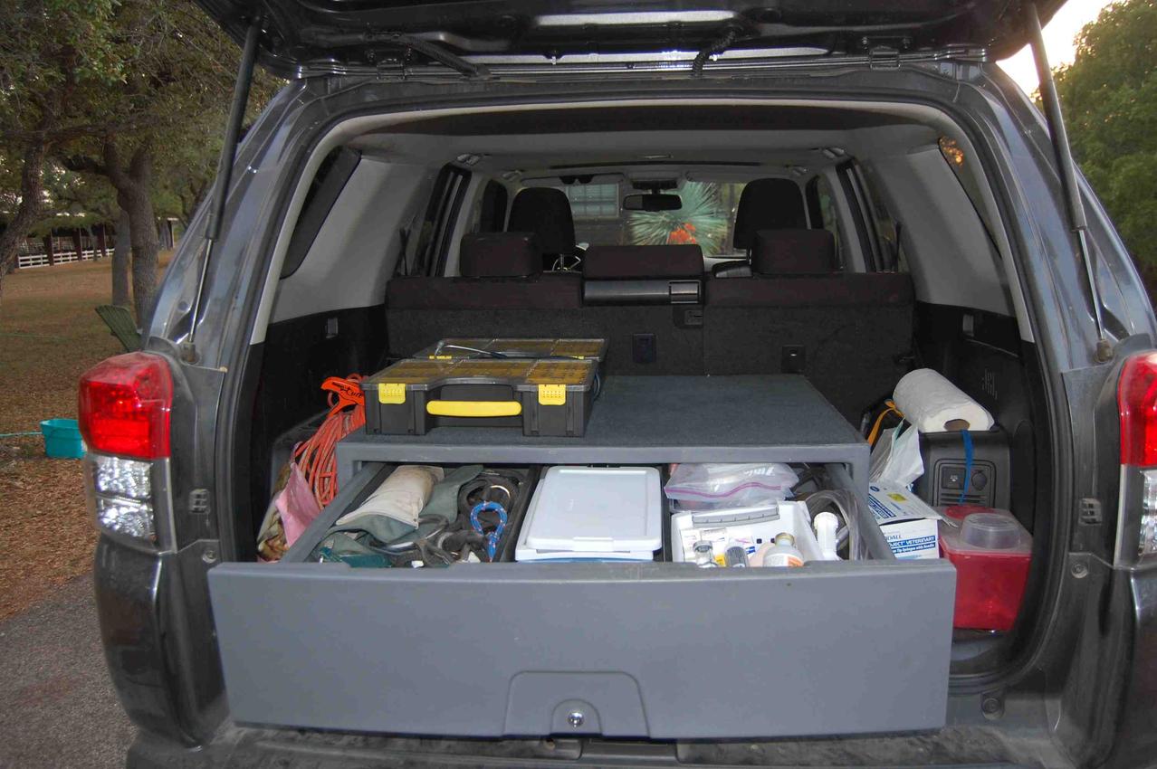

She got bigger, with more room to store things (in this case, veterinary medical supplies)

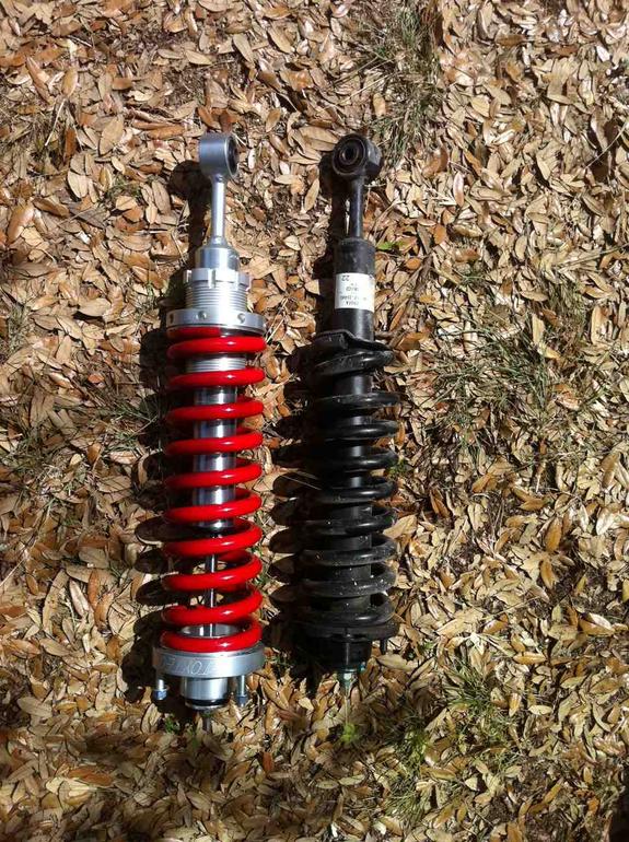

After swimming for a few months, she developed legs.
With those new legs, she was able to swim faster, but still was shy.

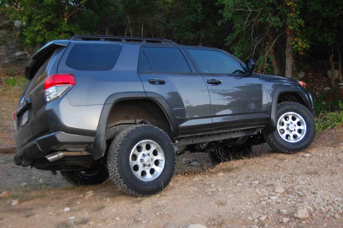

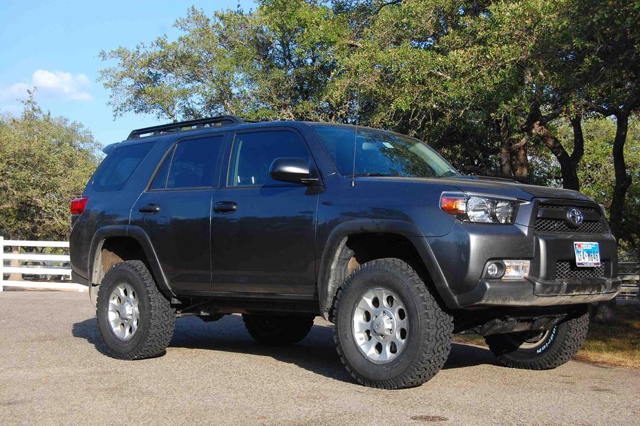

After lounging on the ocean floor for a week, she allowed her legs to settle in, and she found a new set of shoes floating by. She grabbed these shoes and headed out on her own onto the land.

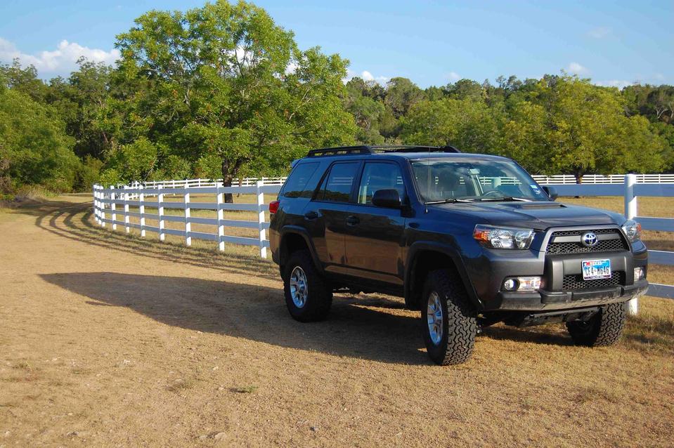

Then she decided that since she was American now, she would get a few glamor shots taken, then show a little flex.
Specs:
3" Toytech ultimate lift, OME 895 Coils rear
Pre lift height (measured from hub to marked highest point on wheel flare)
LF 19 3/4 RF 19 1/2
LR 21 1/2 RR 21 1/4
Post Lift
LF 23 1/2 RF 23 1/2
LR 24 RR 24
a week past "settling" were 1/2 inch lower than previously measured on all corners.
Alignment details (this was performed by an extremely talented mechanic and was verified by 2 other technicians)
PRE
L -0.01 Camber R 0.8
L 0.08 Caster R 0.08
L 0.95 Toe R 0.98
AFTER
L -0.1 Camber R -0.05
L 1.0 Caster R -0.7
L 0.00 Toe R 0.05
Alas, UCA are now ordered and on their way.
