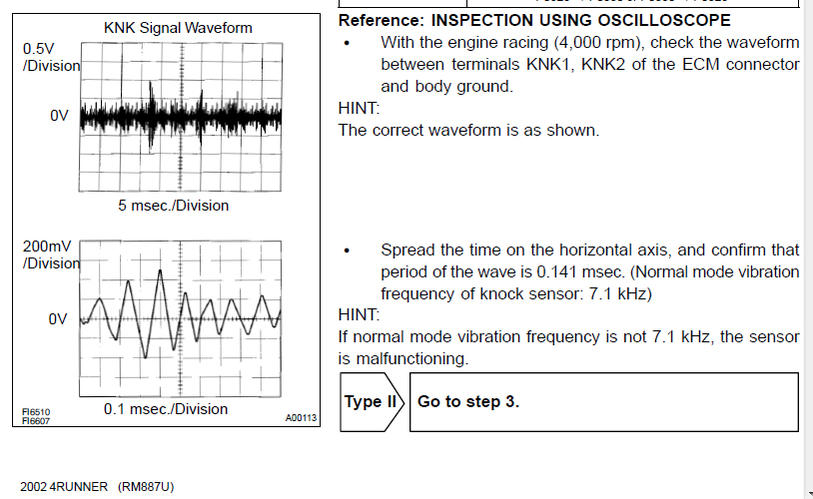

From my understanding, and experience, the P0330 fault is actually the ECM reporting a faulty sensor/wiring. Unfortunately, the sensor doesn't control anything. It's job is to just report the status of the bank to the ECM using a VERY specific (OEM ONLY) voltage wave pattern so it can adjust the timing accordingly.
When you get the code, the ECM will put your rig into max retardation to protect the engine. This is one of the nine DTC codes that forces the ECM to go into fail-safe mode. You're indication that you went into "limp" mode is your gas gauge goes down faster than your RPM gauge goes up.

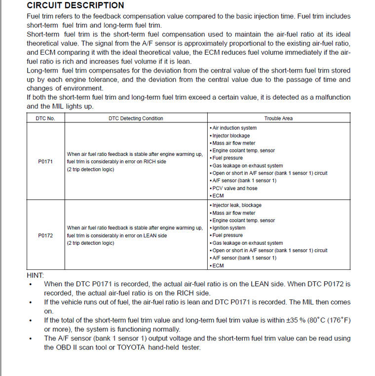

I've attached two screen shots from the manual. I actually had mine scoped at Toyota and saw the faulty wave pattern. The ECM is looking for something very specific from the knock sensors, completely unrelated to the P0171.

Yes, I believe this is actually one of the codes that is reset with the ignition off. In other words it's not latched. As soon as you start it and run up to 1700 RPM or higher and the ECM doesn't see 7.1kHz the CEL will come back on. While driving you MUST reset the CEL which takes it out of limp mode until the next time...whenever that may be...10 miles, 40 miles, 100 miles...(Hopefully never.)
