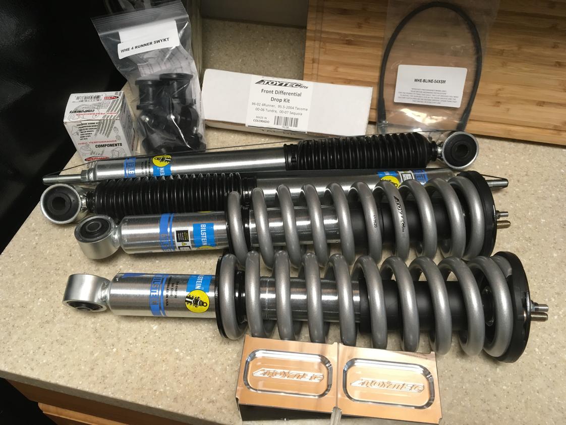

I just finished installing a 3" lift on my 99 T4R yesterday. I have not gotten an alignment just yet as I was hoping to figure out this issue first to avoid having to get another alignment afterward. I installed the following parts:
Front:
Bilstein 24-248730 (https://wheelersoffroad.com/i-30857...r-1996-2002-4runner.html?ref=category:1388356)
Toytec 112-620 (https://wheelersoffroad.com/i-25490...-fj-cruiser-112-620.html?ref=category:1346101)
Front Dif Drop TT TAC-DR (https://wheelersoffroad.com/i-254903...ra-tac-dr.html)
Front anti-sway kit WHE 4RUNSWYKIT (https://wheelersoffroad.com/i-254903...runswykit.html)
Longer Sway Bar end links for REAR 99 T4R (https://www.rockauto.com/en/moreinfo.php?pk=1057046&cc=1357455)
Rear:
Bilstein 5100 long travel 9602E703 (https://bilsteinlifts.com/shop/toyot...oyota-4runner/)
LC 8 wrap coils
Rear Bump Stop Drop Kit TT RM43010-TTL (https://wheelersoffroad.com/i-254903...43010-ttl.html)
Rear anti-sway Kit PTHANE 18-1116-BL (https://wheelersoffroad.com/i-254901...8-1116-bl.html)
Longer Sway Bar end links for FRONT of 95 T4R (https://www.rockauto.com/en/moreinfo.php?pk=8730328&cc=1272529)

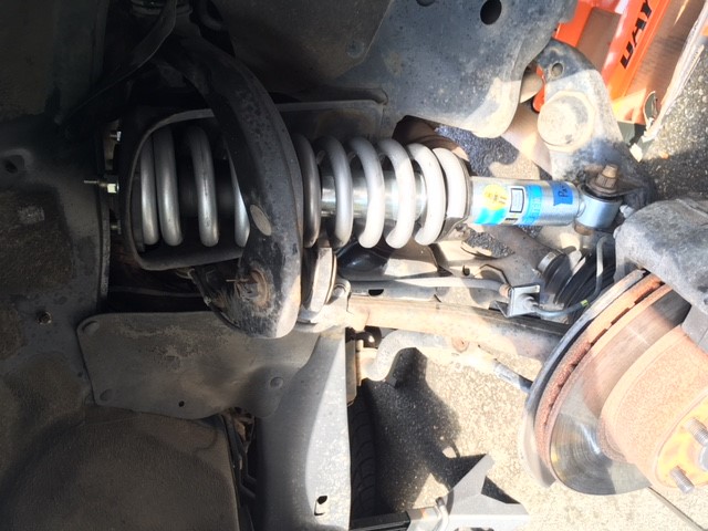

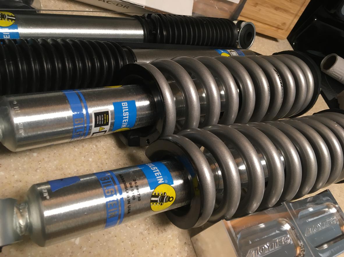

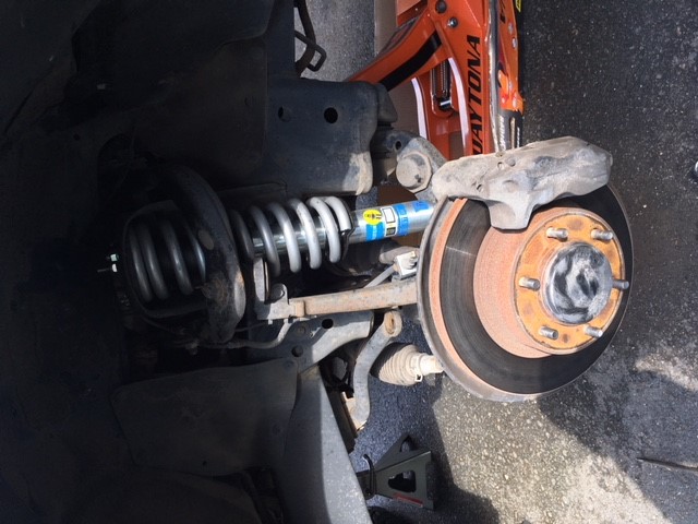

I installed everything at my buddy's house and he lives about 30 minutes away from me. When we were finished, I drove home and I noticed an excessive bounce in the front end. It doesn't matter what speed I am going. It rides as though it is sitting on the front coils with no shocks. I set the front coil clip on the 3rd notch up. These shocks are the 4Runner specific Bilsteins, not the Tundra shocks.
I have not taken measurements just yet to see just how much lift was gained but the front does site pretty level with the 8 wraps in the rear.
Here are some pics: I did not take a ton of pics as these were taken before and during the install and I did not know I had the problem yet. I will take more and upload.

Pretty sure you have the Bilstein's cranked too high, with a 3" coil they should be on the bottom perch per ToyTec's website.
I guess that makes sense. I was thinking the clip is what set the ride height. But it would make sense that the coil would.
I opted for the Tundra billies with those coils (24-248730) and I installed them on the bottom notch and have no bounce.
Question: what shock cushions/bushings are you running above and below the top plate?
IIRC the bilstiens only come with one shock bushing (unless wheelers bundles bushings with the shocks they sell)
If you're front is level with 8 wraps then you've answered your own question. You need a plate bumper & winch to be on the 3rd perch.
Rides like a dream now. Thank you everyone for your assistance. It’s crazy how much of a difference moving that clip down an inch and a half makes!
