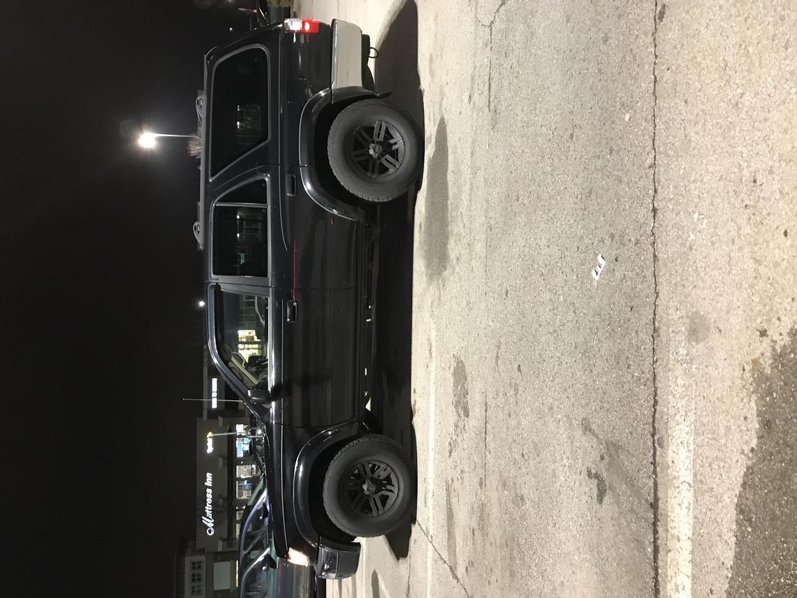

Update: snapped my collarbone and had surgery so I’ve got time to brainstorm on the upgrades. But right before I Removed running boards/ new K16TR11s and fixed the broken antenna cord.
OME 906 in the rear for a 2” lift and 880s in the front. From what I have read these are not good choices if I’m not running armor as it will be a rough ride. And I believe the 880s is around 2.5” lift in the front so I need to re evaluate.
Other option go with 99s all around, believe it gives a 1” lift or so over factory and prob would ride a lot closer to OEM quality. Would I need to replace shocks as well to help with a smooth ride? Which shocks?
Decent video on the 99 upgrade shows about the lift I’m looking for
https://youtu.be/AtAJOsQzWOw
Any recommendations would be awesome as im not wanting anything over a 2” lift.
