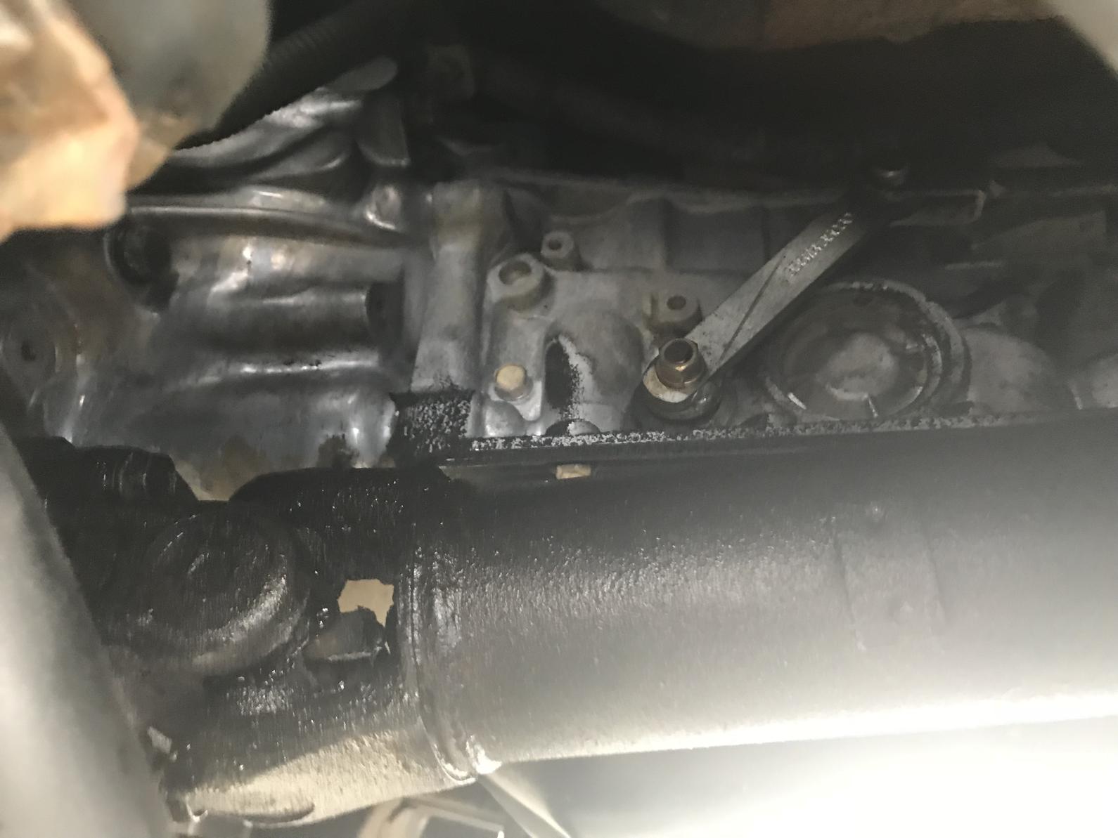

View attachment 286288Quick update, thanks to the forum here I greased up the driveshaft and the sound is almost completely gone!! Still does it very little, about a 70-80% difference. Thank you! The rear of the front drive shaft had two grease points (5 pumps till a little grease started coming out) the front part of the front shaft only had one grease point (3 pumps). I was in so much pain from my surgery I had to get up but couldn’t resist no seeing if this resolved my noise. I got to thinking does the front part of the front shaft have two points? The remaining sound could be from that second point if so.

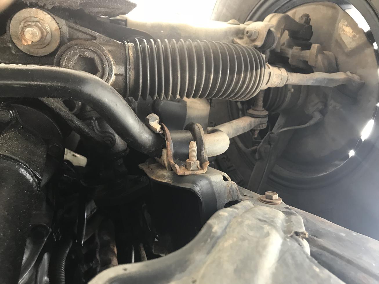

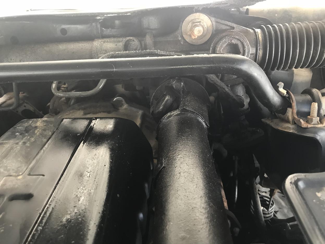

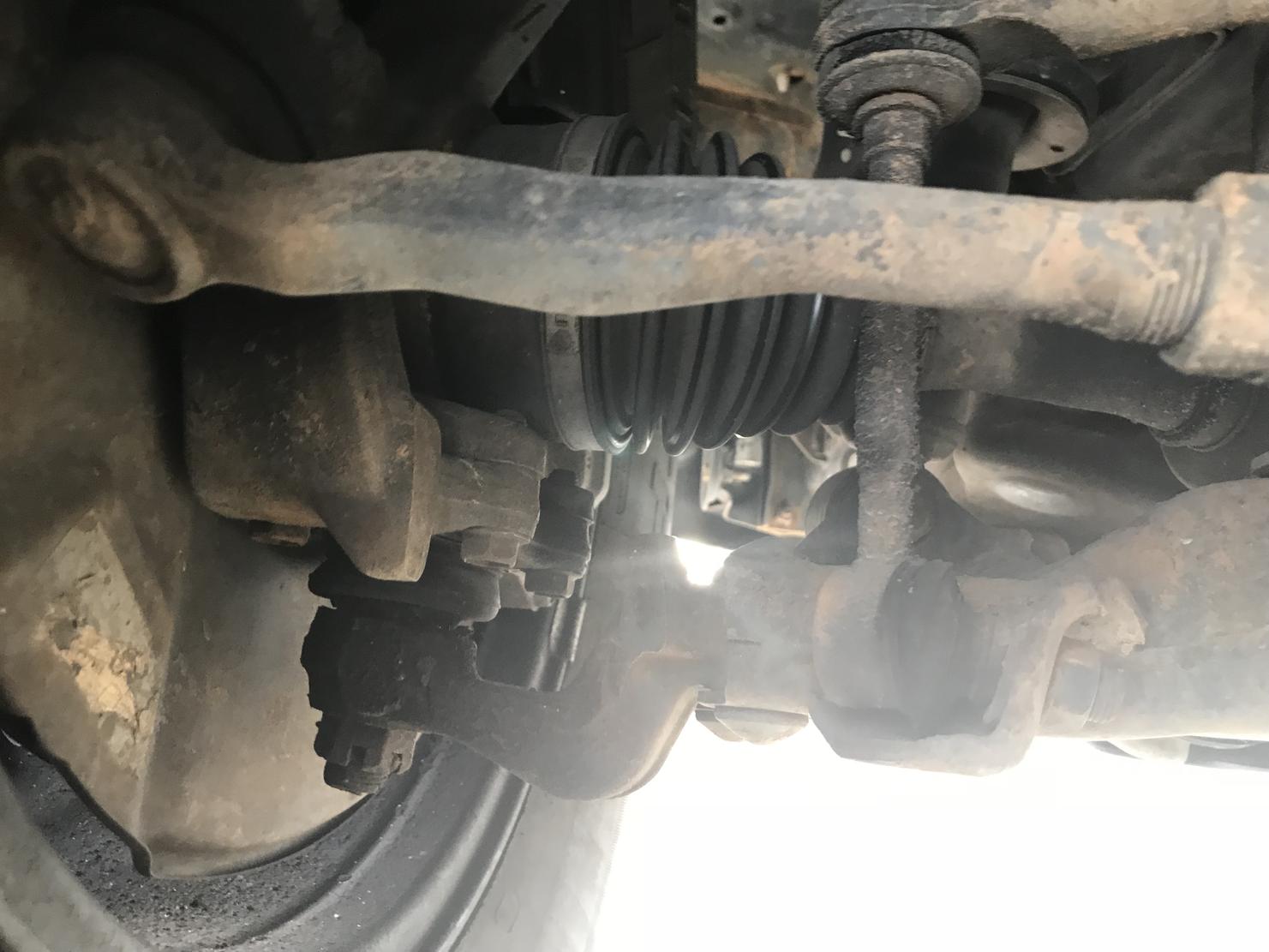

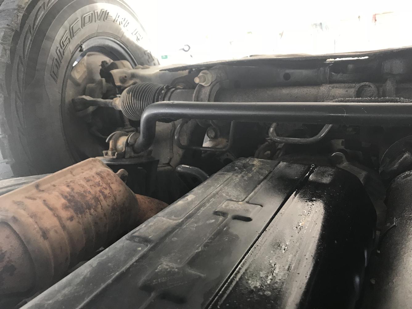

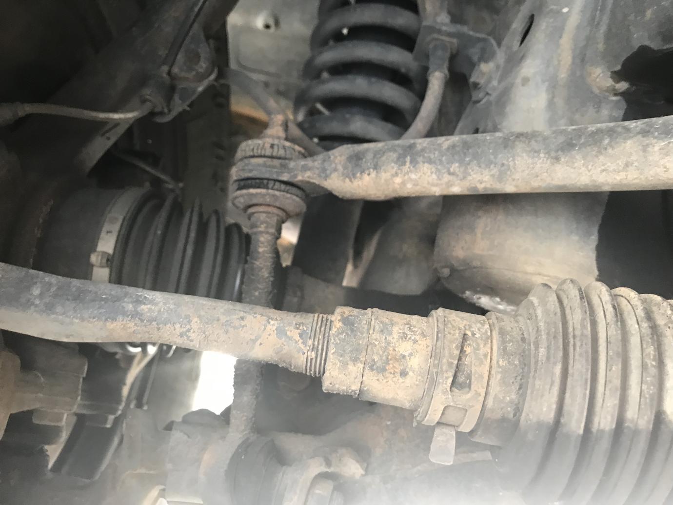

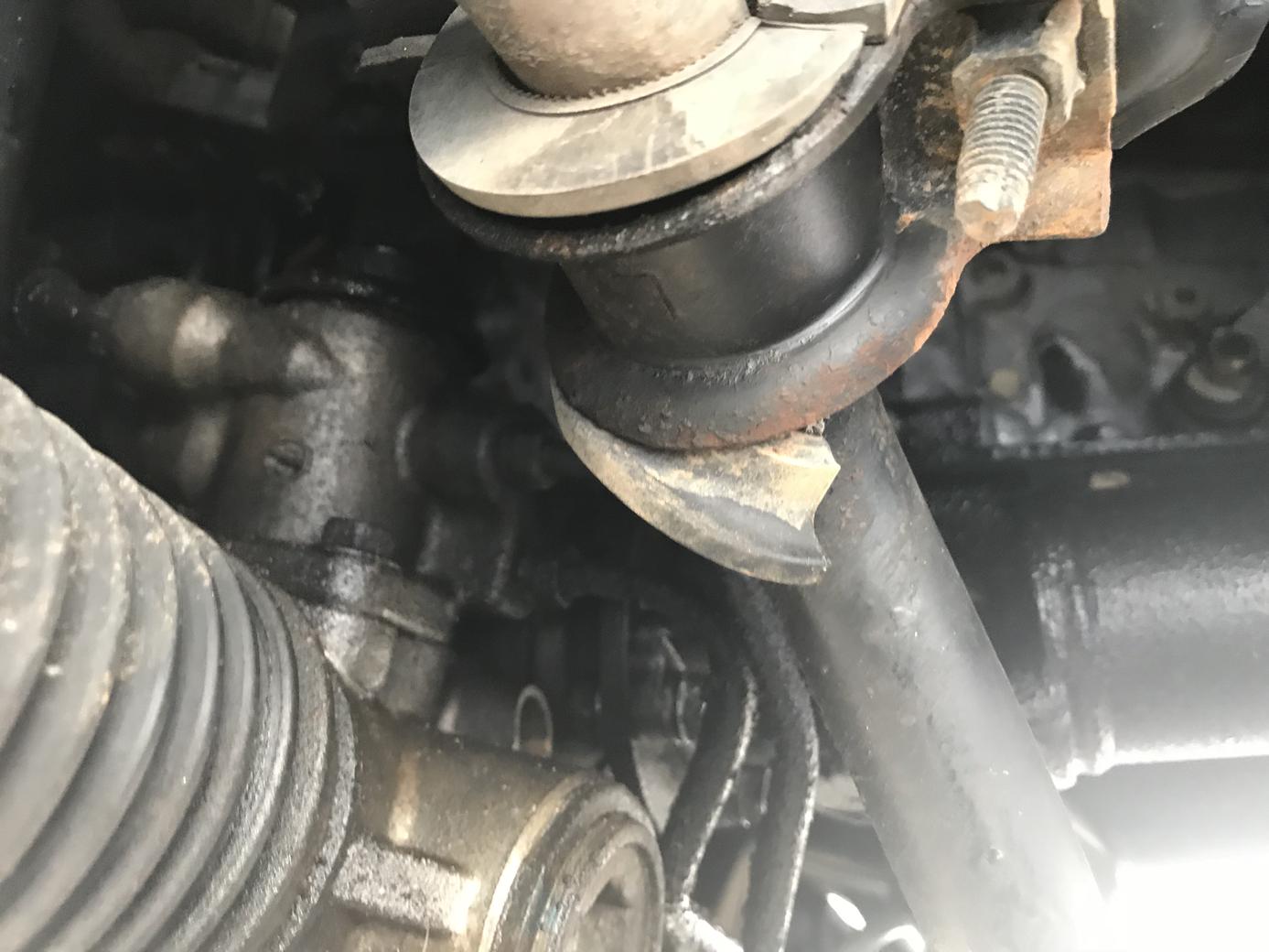

Also uploading some pics below (sorry so large) looks like a steering rack leak possibly? Thoughts? Also taking recommendations on the LBJ condition if these need replaced or not. Found sway bar bushings are bad (anyone know part number?) also the sway bar end link bushings look rough? (Thoughts?)

The LBJ sometimes show no signs of failure before failing.
You can go on youtube and watch videos on how to check them for excessive play.

Yes, I would say you need new sway bar bushings all around! But at least your end links are still intact. When I bought mine the two fronts were sheared off. I knew I was going to go with a 3" lift anyway so no big deal I needed longer ones (2nd gen rears work well in front with 3" lift). And regarding lifts, I know you just want a small lift but I went with the toytec 3" with the super flex coils in the rear and I'm very happy with the setup. Fits 285/75/16 BFG KO2s easily with no rubbing.

I would change out the lower ball joints just to be safe. That was one of the first things I did to mine when I got it. Looking good so far, and enjoy the process.

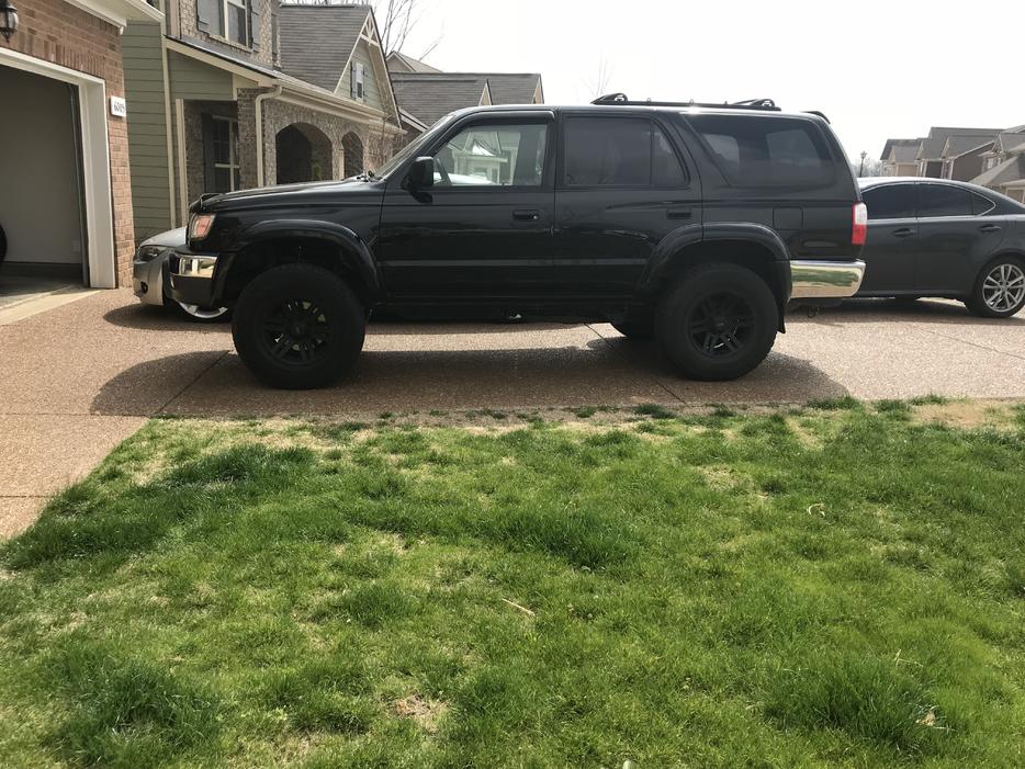

I ordered some new LBJa this week to get installed as well as tie rod ends and sway bar end links. They looked a little rough when I installed the lift. The front is a full one inch higher then the back according to measurements. The shocks were sent set up from wheelers on the top perch so guessing they could have been set to the middle perch. I honestly am not going to take the front completely apart again to level this out as it was a pain to get the front lined up to begin with.. Would a 1” rear spacer work? Thoughts? 37” in the front and 36” in the rear
