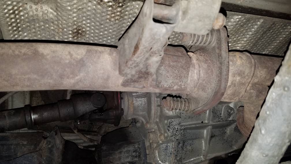

Unbelievably annoying ticking rattling sound has finally crossed the threshold of being able to be ignored. This is Literally the only unnecessary noise my truck makes lol.
The culprit is the flange between where the muffler pipe connects to the y-Pipe at the spring joint.
What is the part number that should be used to replace those bolts and the gasket. I could not find a definitive answer.

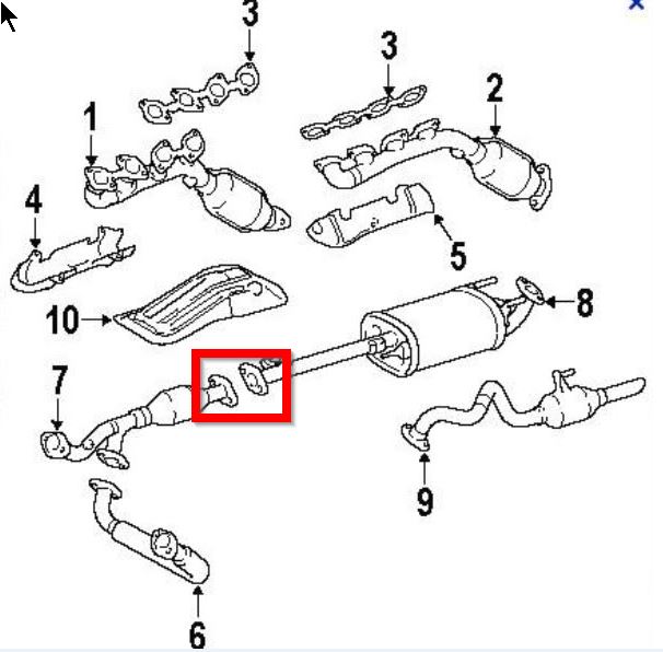

Those flanges are part of the exhaust/pipes for my 06.
I would not expect Toyota to have a separate part# for just the flanges.
Aftermarket flanges should be available.
When my exhaust got dismantled, I believe there was a rotted out gasket at that location. :doh:
The Walker(?) catalog should list a part number for the gaskets.
So it appears the sound was being generated by the spring bolt- Spring, rubbing along a rusted bolt as it flexed just slightly, over bumps or under acceleration. Kind of like nails on a chalk board effect.
I used a pry bar to compress the spring joint and separate the flange slightly and loaded up the bolts and the flange with anti seize. the noise is completely gone for the last few days. This is a great temporary fix.
If it holds long enough ill re apply and save for catback. If it comes right back ill fix the flange.

Yes I replaced the donut gasket and the spring bolt the flange shown in the picture above and it fixed it.. since them I have change the exhaust system from that point back and have not had another other issue with it. The noise is actually the spring flexing on a the rusty bolt.

the flange that i fix is the part between part# 6 and part# 7 as shown in the picture. i had to cut the pipe so it has a space of around 4-5 inches and installed a 2 VW clamp a pipe reducer. worked great!
