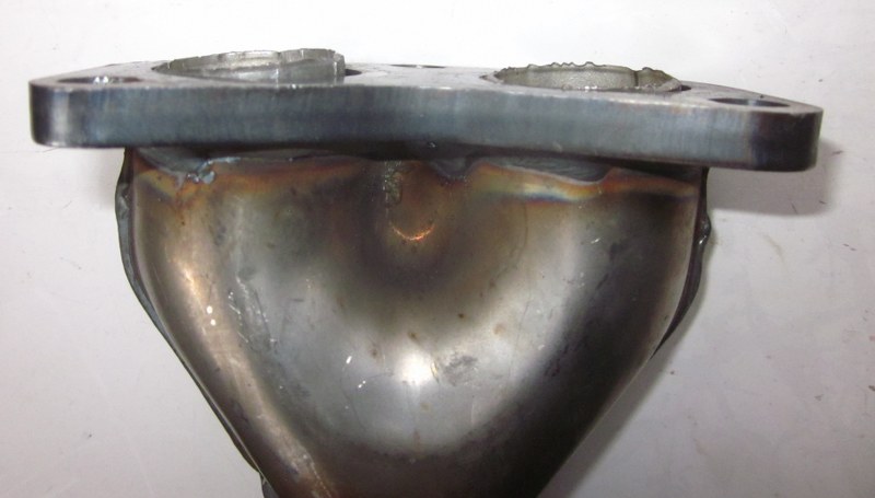

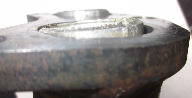

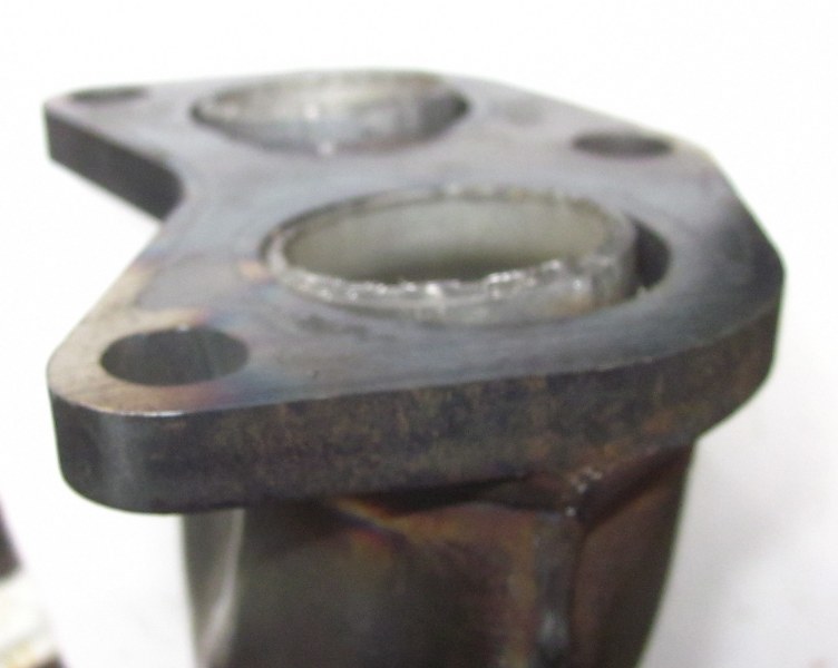

I recently purchased a Walker cat for a 4-cylinder, Federal 4Runner. I took some photos of the end where the cat connects to the exhaust manifold. The two stubs need to rise above the mounting plate about 1/4" so as to position the gaskets. Looks like a Walker welder got in a hurry, and the quality inspector was asleep.
At present I'm negotiating a return. I'll gladly use a properly manufactured Walker item. Or, the vendor may offer me some money and I could get his one fixed.
Seems exhaust companies are the worst for quality of workmanship. With the exception of the Borla I mentioned above, I've never had an exhaust that came ready to go out of the box with no modification required on my end- even for stuff that's supposedly model specific.
